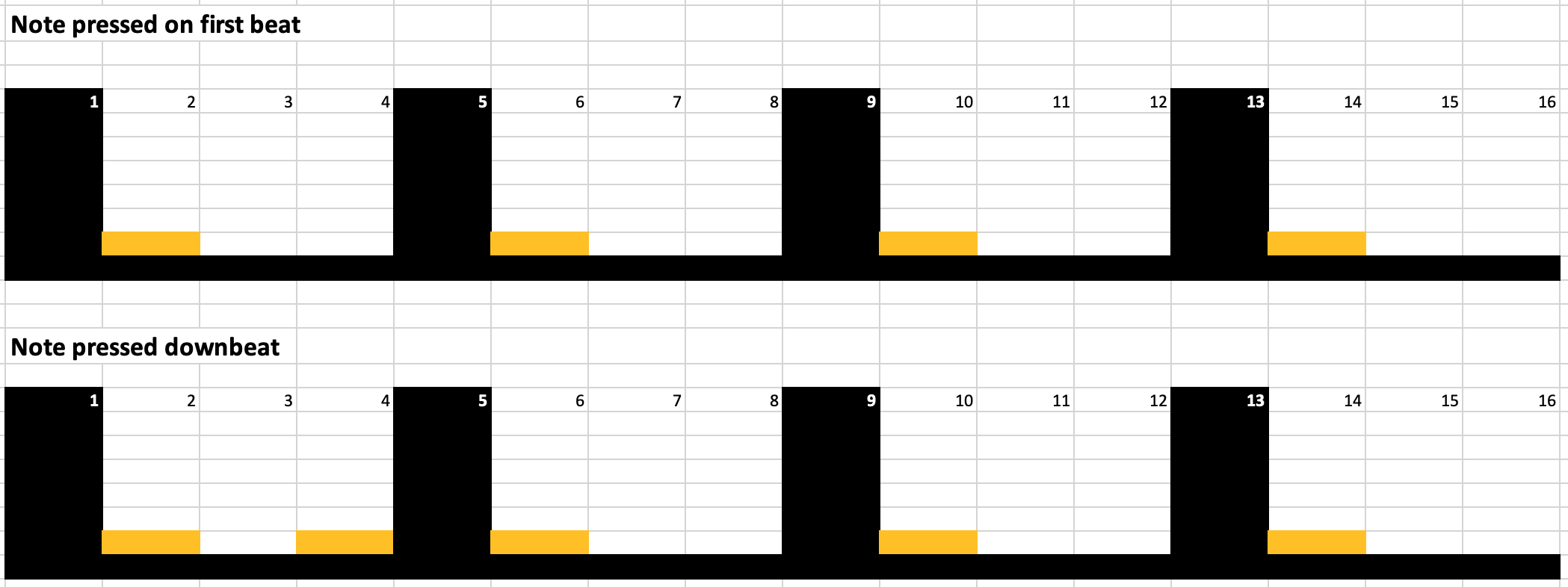

  1. The internal clock is allways running in the background. So when the sequencer is on and you press a note right on time of the beat the envelope is just triggerd as the first image in the attachement. Just as you would expect.
If you press the note at any other timing the envelope triggers, but restarts at the beat again. Therefor you notice a glitch or second retrig. This occurs everytime when the sequencer return to it’s original value.
