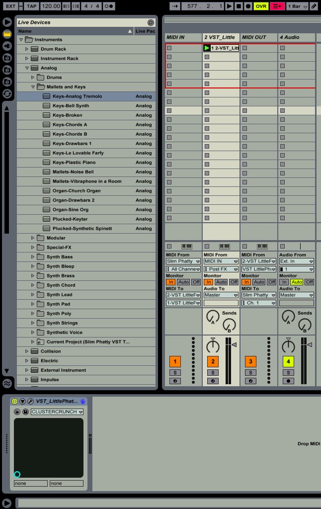

Howdy all,
I’m pretty upset… just spent $69.00 USD on a VST Little Phatty Editor which is supposed to work with the Slim Phatty as well, e-mailed Moog and they said that the editor does not work with Ableton Live after I bought the VST Editor… I was like what? :open_mouth: then I e-mailed Rekon Audio (Maker of the VST Plug-in for Moog Music) and they said that it does work on Ableton Live and they sent me a screenshot of an Ableton Live set up for a different Syhtn editor other than the Little/Slim Phatty :confused:
Rekonaudio’s support regarding the midi set up inside Live for their VST Editor has been pretty much useless so far, I guess I will continue to bother them until they give me exact details as to how to MIDI set up this damn editor.. If anyone has figured out the set up for Ableton Live PLEASE, PLEASE take a nice and clear screenshot of the three MIDI channels and one AUDIO chanel needed (as per Rekonaudio) and post it to this thread.. I’m sure a lot of users would really appreciate it. I’m so disappointed with both Moog Music and Rekonaudio for not having some sort of CLEAR MIDI set up manual for this Little/Slim Phatty VST Plug-in for major DAWs (In my case Ableton Live)
All I read all over the web is hundreds of users having this same exact problem saying things like: “Little Phatty VST Plug-In is a complete waste of money” and so on… Common’ Rekonaudio… if you’re going to do something do it right or just don’t do it at all..
Any pointers would be greatly appreciated

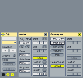

Looked and looked for that “pattern parameter” and cannot find it… this seems that is the solution to most of my issues.. if you could shed some light on this I will be most thankful.

Also I’ve attached an image of where the pattern setting is in your clip setup. It’s actually called ‘Program’ sorry my bad :stuck_out_tongue:
Hope this helps!

Thanks man… I was going nuts looking for “Pattern”.. I’ll give it a shot when I get home..

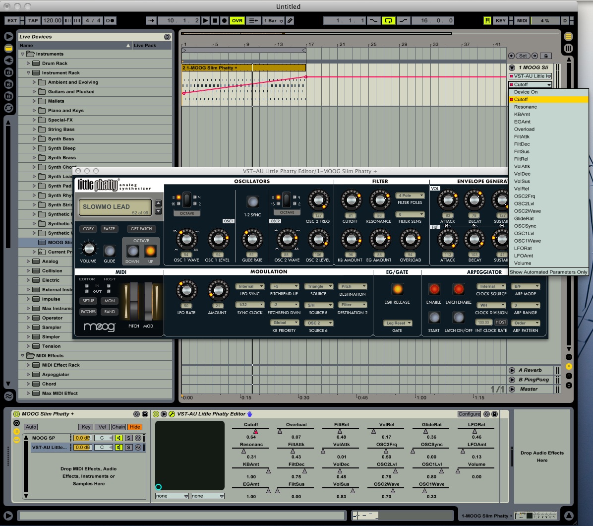

Well gentlemen, I must say that Amos from Moog Music is a very committed individual… he has taken the time and sent me the updated (unreleased) MAC version of the VST/AU Little/Slim Phatty Editor which it isn’t 100% functional as of yet but I thing we’re almost there. So far I’ve gotten all the parameters on the VST/AU Editor to sync with my Slim Phatty and I have actually been able to automate all the parameters via VST/AU, however the only issue right now (BIG ONE though :frowning: ) is that the automation on the VST/AU Editor parameters is not affecting the sound of the Slim Phatty which I’m assuming has to do with the AUDIO/MIDI set up somewhere along the line.. I’m pretty confident that with Amos’ help we will be getting this to work 100% on the MAC platform.
TIP :exclamation: : The best way to set up the VST/AU Little/Slim Phatty in Ableton Live is to create a MIDI channel, then create an INSTRUMENT RACK, then throw in both the EXTERNAL INSTRUMENT TOOL and the VST/AU Little/Slim Phatty EDITOR inside the INSTRUMENT RACK you just created… to get the parameters you need to show up on the on the VST/AU Plug-in signal chain (at the bottom of your screen), click on the “Configure” button and just click and wiggle on the VST/AU Plug-in window the parameters you want/need, these will then be configured and will show up as a fader on your VST/AU Plug-in signal chain (at the bottom of your screen) and be ready to be automated on your arrange view window.

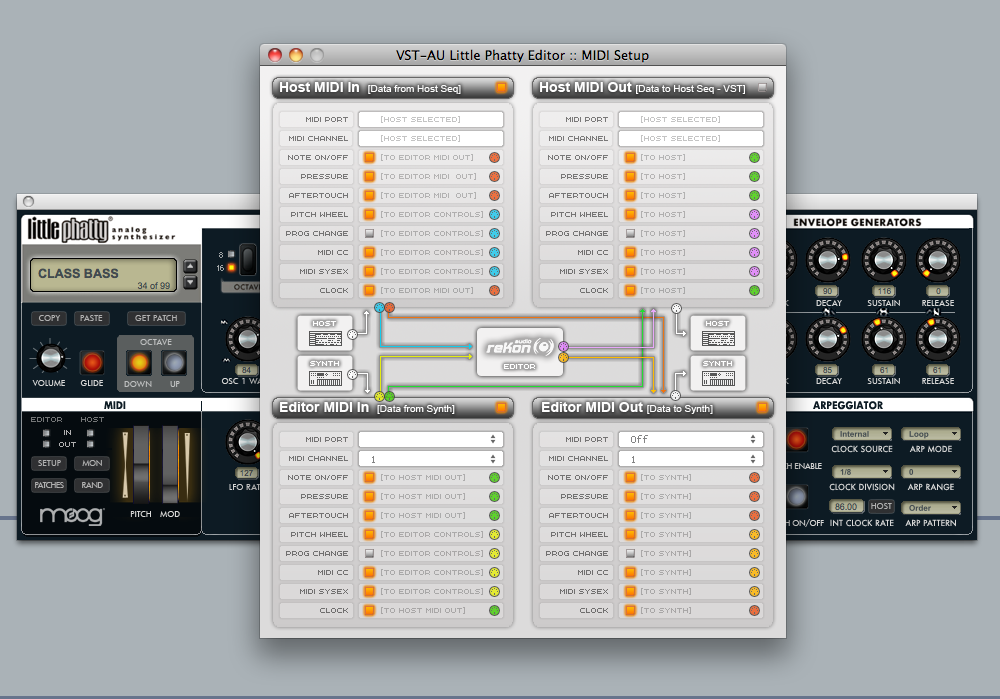

If you have any questions so far, do not hesitate to ask.. I’ll be glad to help, please see attached screenshot of my progress so far…
I’ll keep you all updated on the progress…
PS. NEITHER the automation data nor the movements on the VST/AU Parameters are affecting the sound of my Slim Phatty wich is the ONLY issue left to resolve, :question: if anyone has any idea as to how to get this issue corrected based upon the set up of the screen shot below… we are good to go!!!
Ahoy there -
in your screenshot (http://www.moogmusic.com/forum/download/file.php?id=158&mode=view):
“Editor MIDI Out” (data to synth) is set to “OFF.” That means no control output from the editor to your Slim.
So, double-check this setting… “Editor MIDI Out” needs to be a MIDI output that is connected to your Slim.
See if that gets you to the finish line, or if it raises additional questions… :slight_smile:
Amos
Thanks Amos, makes sense however I can’t seem to know where this “Editor MIDI Out” parameter you speak of is located, if you could point that out to me would be most helpful. A “zoomed in” screen shoot from my own initial screenshoot would be wonderful… as they say: “a picture is worth a thousand words”

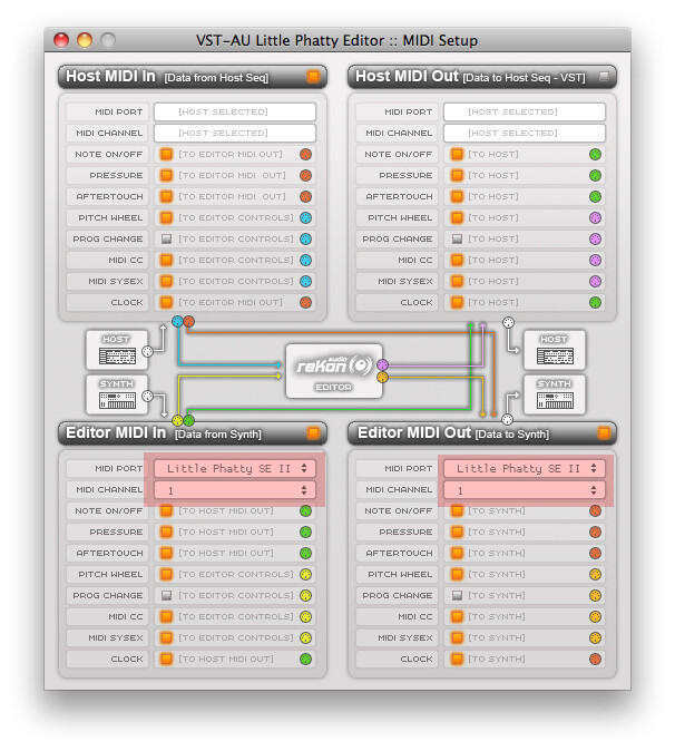

Hi Jpromano78…
Refer to the below screenshot.
Happy tweaking!

Ha, I had just finished a much uglier version of the above in MS Paint.
well done, that man :slight_smile:
acatcalledanarchy THANKS!!! :wink: It worked like a charm!!! I got everything working perfectly now… Well almost there… I’d say 95% there!!! The only thing I need now Mr. Amos when you get a chance please send me the .fxb file for the Slim Phatty Factory Presets so that I can load the on the AU and we’re done!!! :mrgreen:
Thanks so much guys!!! For those of you who think that the VST/AU Editor for the Little/Slim Phatty does not work… please read this: IT DOES WORK and WORKS WELL (At least on Ableton Live) INCLUDING THE AUTOMATION OF ALL PARAMETERS… Note :exclamation: MAC VERSION ONLY… for now…
