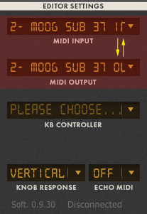

Setup Editor Settings Midi In Midi out Layout not correct.
See Picture.
Regards Luloop.

Hi Amos,
What i mean is that the Gui is wrong.
See picture.
2- Moog Sub 37 In
2- Moog Sub 37 out
There is something missing.

Luloop, not sure what you mean. What is missing ?
Just look @ the picture and the 2 yellow arrows.
The N from the In and U from the out is not correct.
Regards Luloop.
This happens because the system has numbered the driver as “2”, so no enough space for the entire name to fit in.
