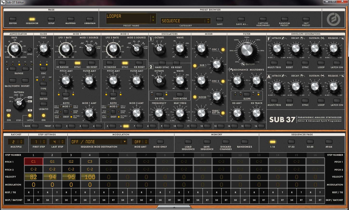

First step Pitch (see pic note in red) is working better now but when I move my mouse just a bit down, The pitch is going one note up.

I think this problem only happens when SEQUENCER OPTIONS: REF NOTE = FIRST NOTE.
Does not happen if REF NOTE = MID C.
It is a bit tricky to solve… when REF NOTE = FIRST NOTE, it means that the sequence is always transposed on playback, such that the first note of the sequence will play as the pitch of the note which triggers the sequence.
So if you hold down a C key to make the sequence start playing, step one of the sequence will play as a C no matter what pitch is recorded in the sequence. The whole sequence will play transposed according to that relationship between the recorded pitch of the first note, and the pitch of the key or MIDI note which is triggering playback of the sequence. This is perhaps confusing as I’ve written it but it seems to be fairly intuitive for most users, so it’s the default setting.
The trouble is when you have pressed a key to start the sequencer playing, and while it’s playing you are editing the pitch of step one in the sequence editor… it’s tricky to determine exactly what is the correct thing to do in this case… and clearly there are still use cases where the correct thing isn’t being done.
