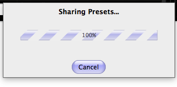

After entering the email addresses, and clicking send, the progress panel appears, showing 100%.
The cancel button doesn’t cancel.

I tried sending a preset without an internet connection – it correctly and quickly sees that there’s no network, and gives a good error message. Quite decent, I must say!
