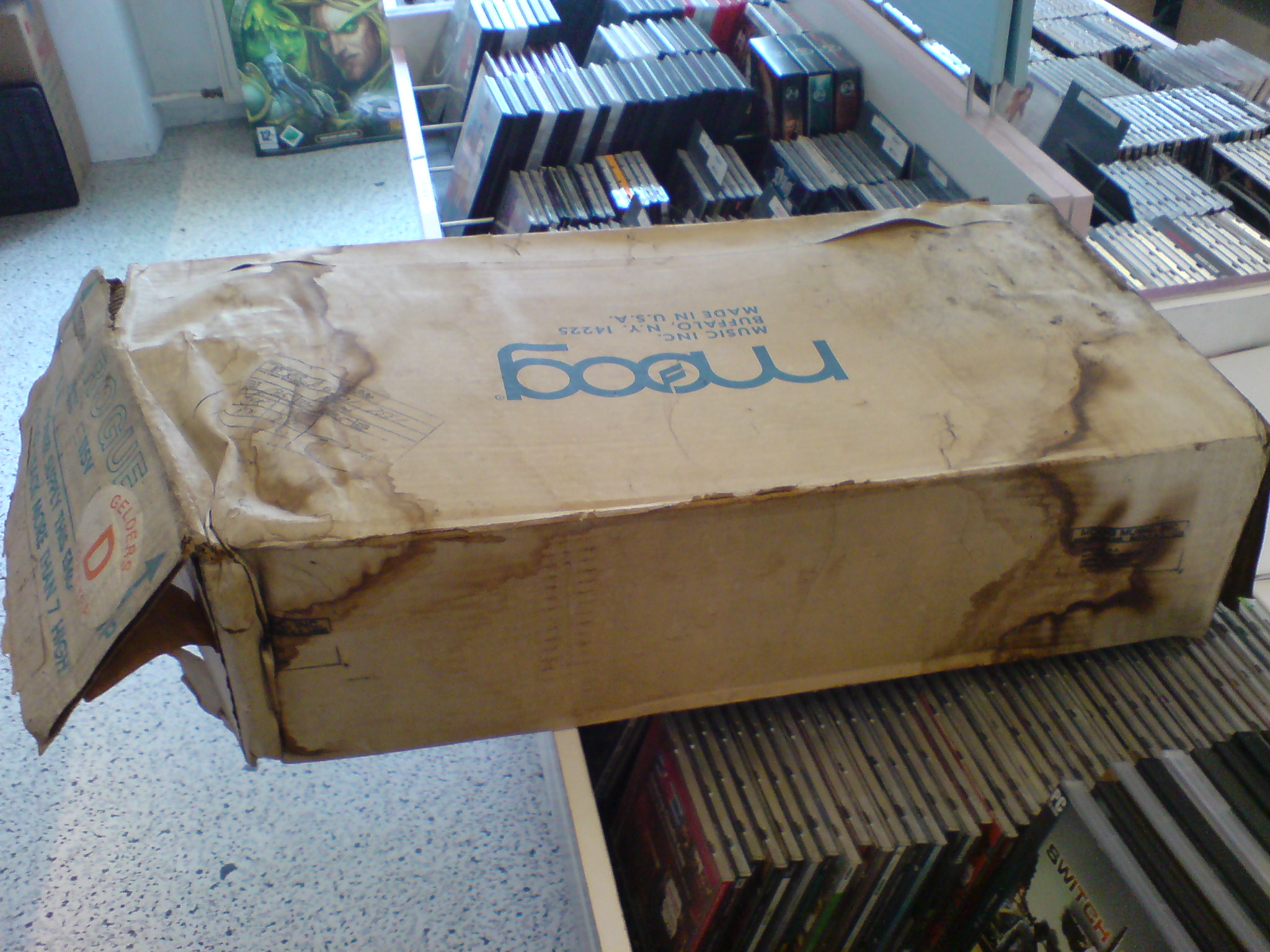

And here, photographs of the carton in which the Rogue was stored for many years. If we get the power supply we’ll try whether the Rogue is still alive… I cross the fingers!

And by the way, it is amazing to see (or better to hear) that the Moog Rogue is still working perfect, although it was stored in a basement and had bad contact with some flood water (see pictures of the original box at earlier posts). Invincible!
