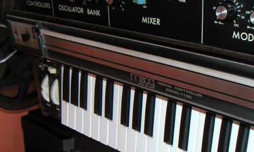

I would like to expand my Voyager by a ribbon controller. My old one (model 1150) suits nicely with my Mini Moog D but cannot be used directly with the Voyager (S-trigger and rear Mini Moog power supply).
Is there any ribbon controller available which I could combine with the Voyager? I’ve seen photographs of a Kurzweil and a Doepfer unit but I don’t know how I could actually could hook them onto the Voyager.

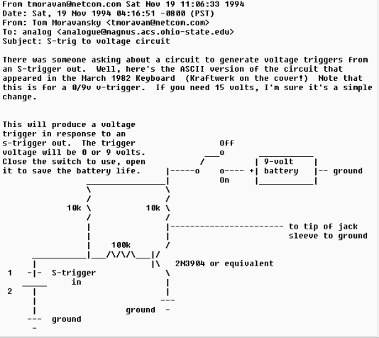

I have a drum controller, and the same problem with the power,s-trigger. I usually use the model D for power, and use one of the 1/4" connectors to CP-251 attenuator to use as a gate into voyager. Is there a workaround for this, or a way to covert a male s-trigger to 1/4"? Ive seen the synthfool 1/4’ to strigger, but that will not work with a male s-trigger.
Just make an adaptor rig. The s trigger is just a short to ground. So, make a small box that has a Cinch-Jones to connect your controller to and a 1/4" out to go to your synth. Inside put a circuit that works a relay or transistor switch that is state changed by the shorting of the s-trig. You can use the power from the Voyager to operate it or you can battery power it with a voltage regulator to drop the 9V to 5V for the output. There was a circuit on the S.COM website but the link is bad now.
Try this topic from here
http://www.moogmusic.com/forum/viewtopic.php?f=1&t=5410&start=0http://www.moogmusic.com/forum/viewtopic.php?f=1&t=5410&start=0
And look at this picture..
