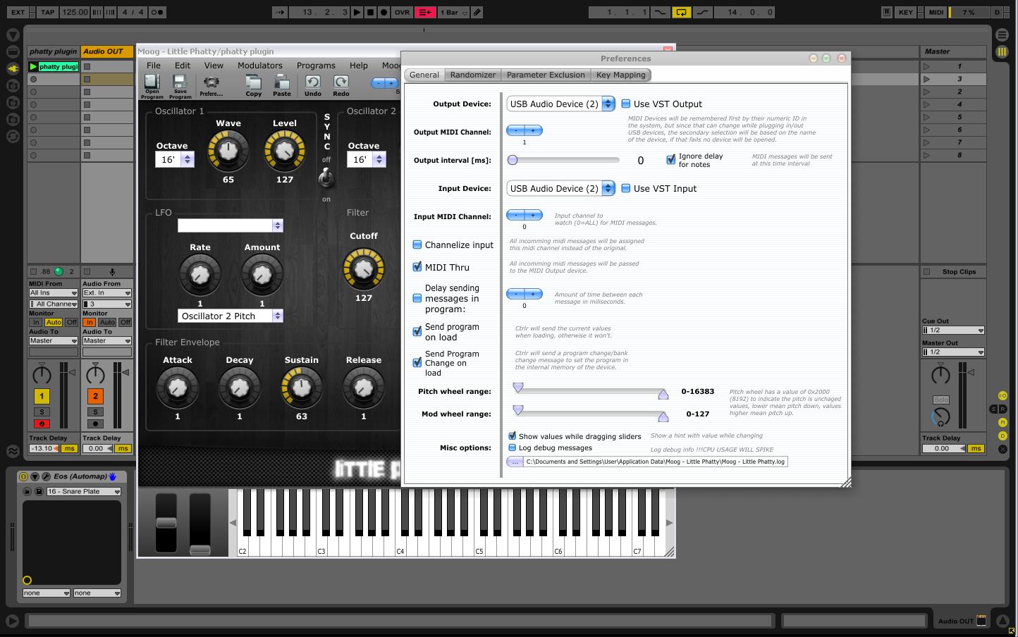

this is the way i set it up works great, I had no need to use midiox an only takes up to TRACKS just unconnected the slim inputs an out puts in ableton preferences
MESA

Yeah man, i tried that here, i turned off the slim phatty input and output in live preferences, chose them in the VST plugin and it works great, i mean, almost. The phatty can control the plugin and vice versa, but i don’t know why it doesn’t send midi from the VST piano keys, you know what i mean? It sends all parameters, but no the actual notes per se.
So i had to set up and external instrument to send the midi notes for it.
Hi there!!
I was able to do it!!
Forget about that midiox midi yoke madness!!
I only needed to check that MIDI THRU box, and now it’s working 100%!
SO, we only need 2 channels (1 MIDI for the VST, and 1 AUDIO for, well, the audio!)!
We can automate ALL PARAMETERS, this vst is really good, im drawing a lot of crazy automations here and it’s responding, incredibly, really smooth!
Totally different than setting up an external instrument device and drawing the automation in the clip.
