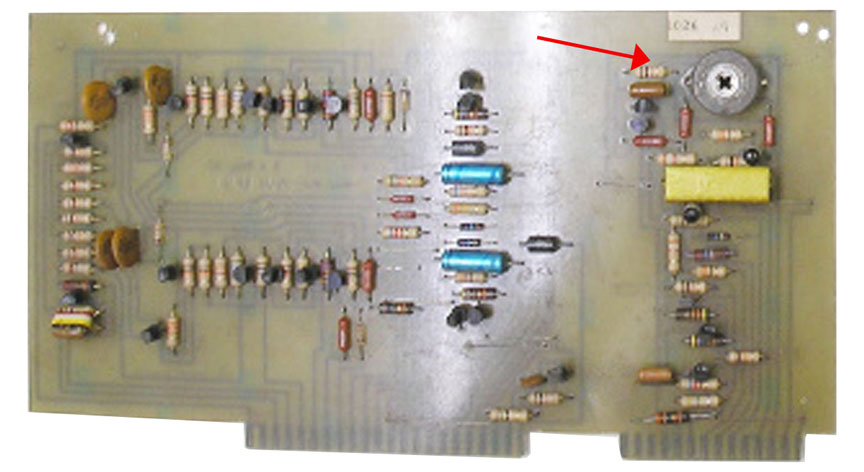

Btw, I recently discovered that at least one very early Minimoog had a board that came with an adjustment for keyboard scaling.
I’ve never seen any other Minimoog with this adjustment present, but it appears to be stock on this particular board below.
MC, have you ever seen anything like this before? Does your RA Mini have it?

Yup, my RA has that trimpot. It was superfluous and another element that added drift so I shorted it out long ago. After a recal, it’s been fine.

Wow. I wonder how many were made like that.
I’ve seen some early ones, but never serviced one like this before and I’ve seen hundreds.
Do you mind if I ask what serial yours is, MC? ![]()
It must be very early.
I had serial #1 model D at my place years ago, but I never opened or serviced it.
(thanks to Dave Kean of Audities for the loan tho.) ![]()
And for those wondering what the big deal is, normally the keyboard in a Mini puts out an approximate 1v/oct CV.
When you tune up the VCOs, you’re tuning them to this approximated keyboard voltage.
That’s all fine and dandy tuning-wise until you send in an external CV from a sequencer or MIDI to CV converter.
Then you have to rescale whatever you’re sending to the Moog because it may not perfectly match the VCOs.
With a trimmer for the keyboard, everything can be made perfectly 1v/oct.
But it was good that Moog removed this adjustment on later ones.
The more things that can go out of tune, the more they potentially will.
(But if someone wants adjustable keyboard CV in their Mini, replace R1 (590 ohm resistor) on board 2 with a 560 ohm 1% resistor with a 50 ohm cermet trim wired inline.)

#1053

I was inside that one and remember that it had all the original cards, including the discrete oscillator card. Didn’t check for that scaling trimpot.
There’s another “#1” out there, but the Audities is the real one - it still has the original serial sticker like mine plus 100% original components.
