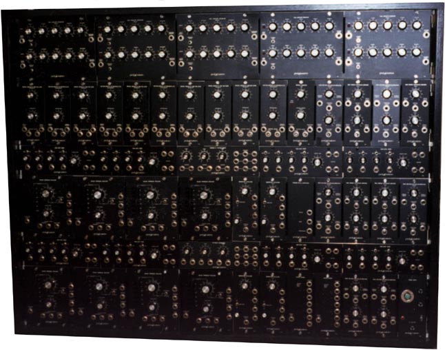

Mine polyfusion System ! .. I know a lot about em … Kevin Lighter sent me all his data about PF few weeks before he passed away

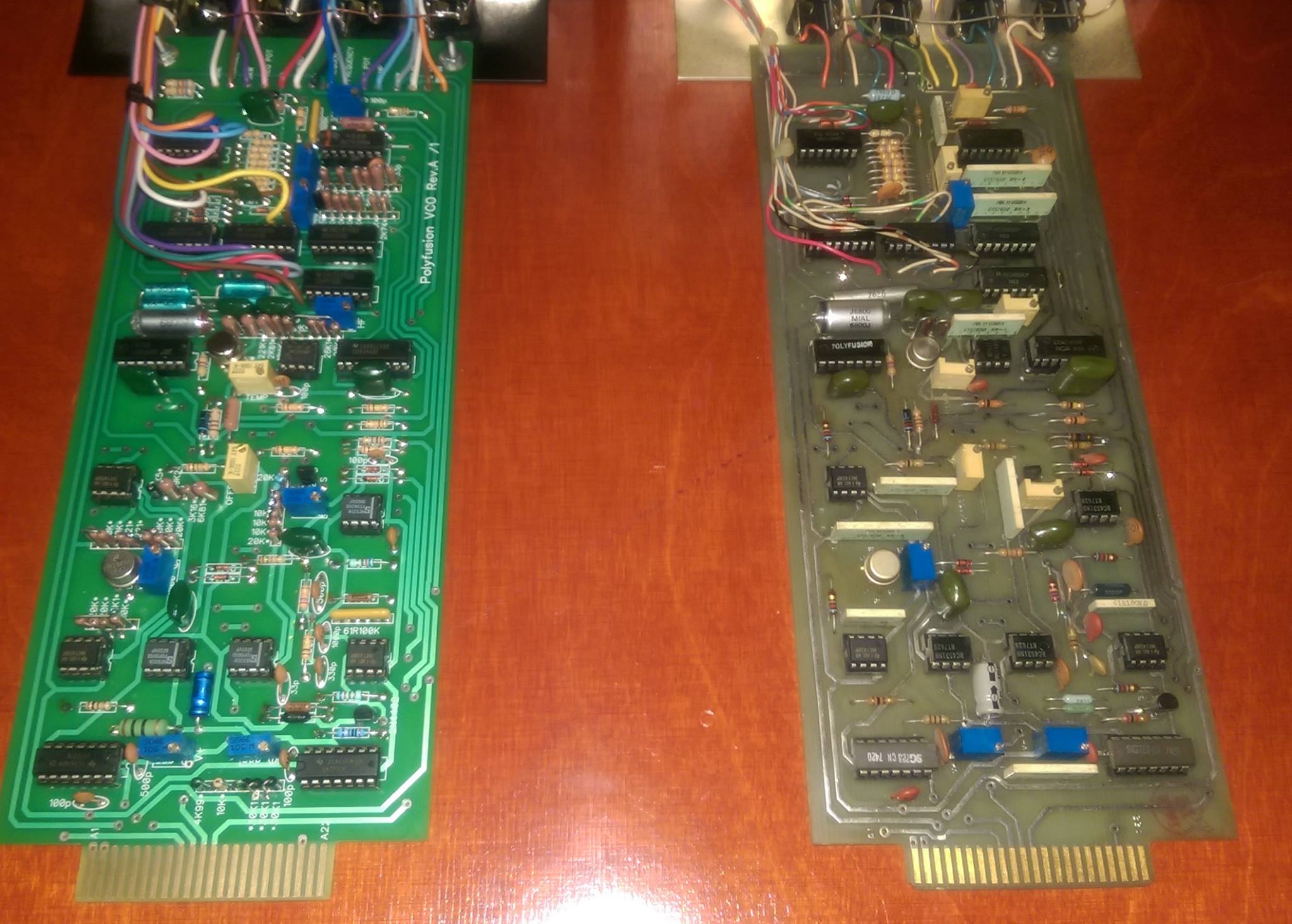

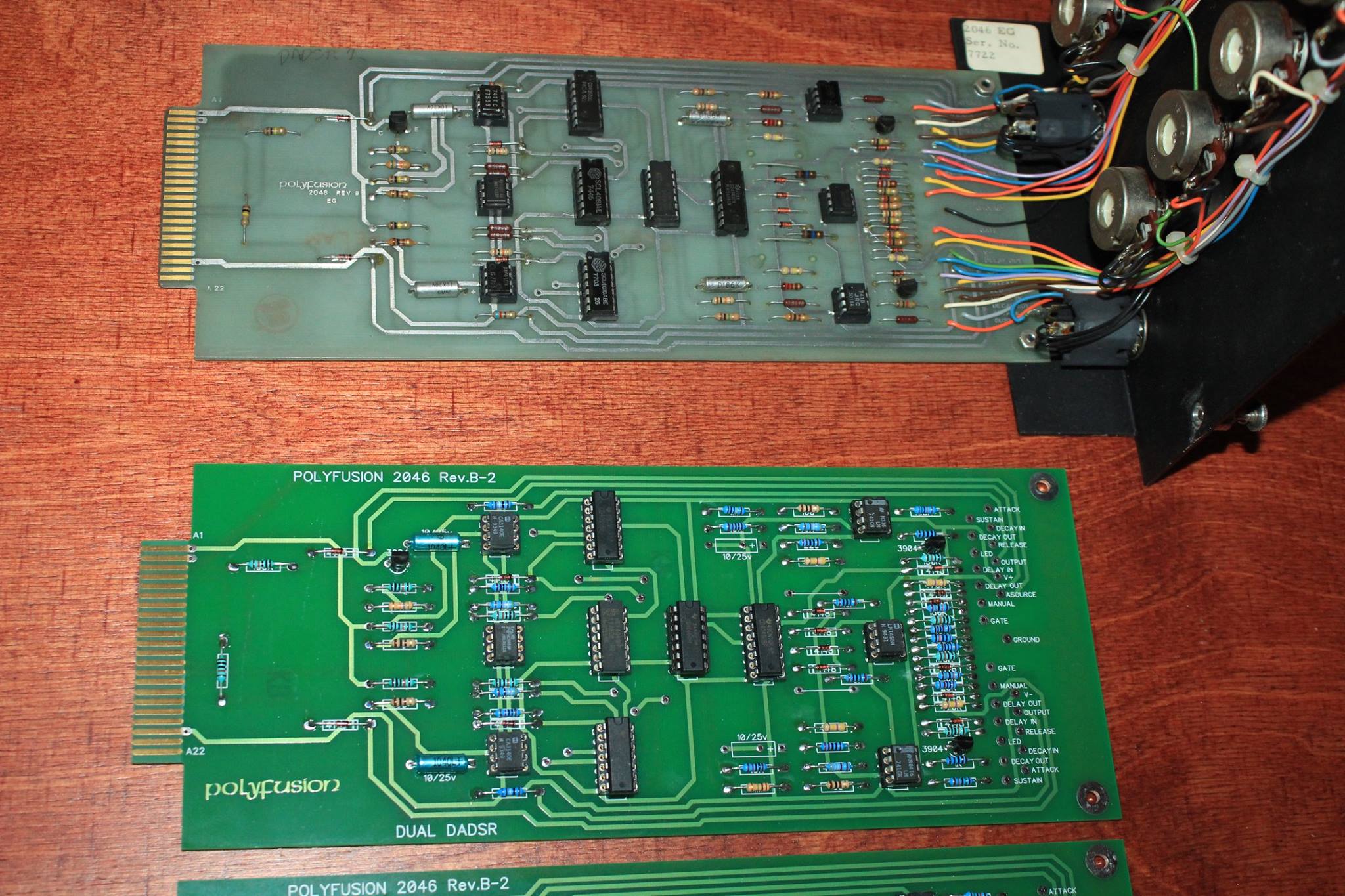

Original VCO rev A and ones I made ( I cloned - not exactly good way to call it ) … I made replica of many modules (but system i have is 100% original beside cabinet i made for it!
left is made by me .. right is original !

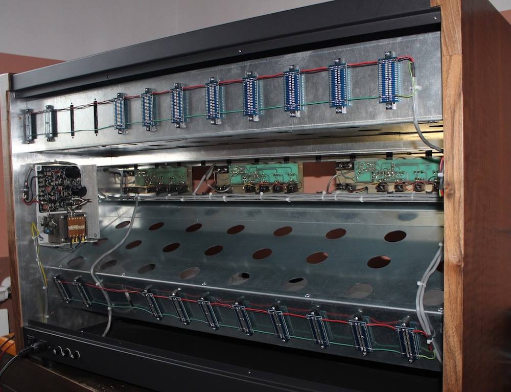

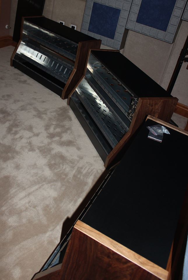

Cabinets we made here

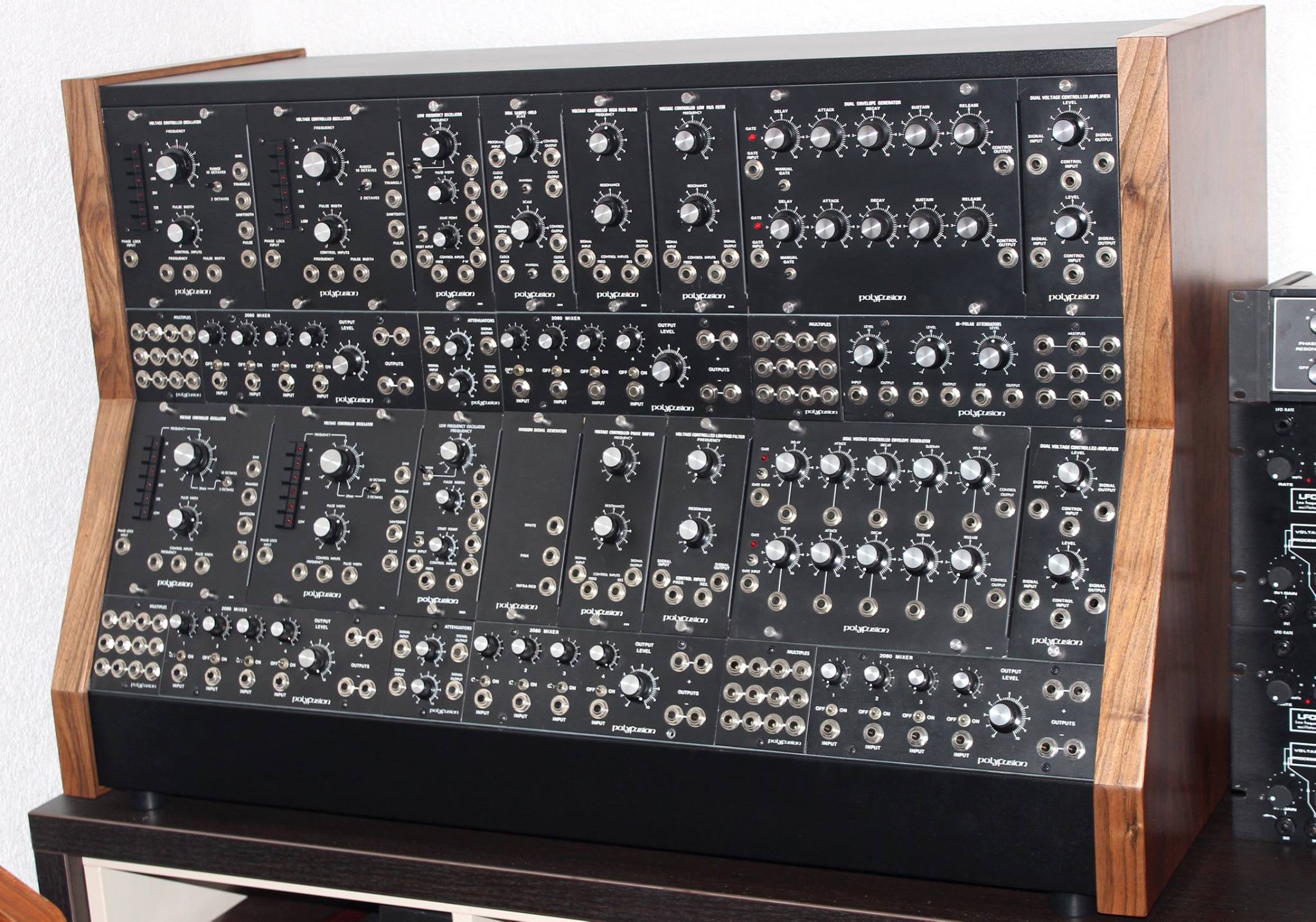

cabinet made for my modules !

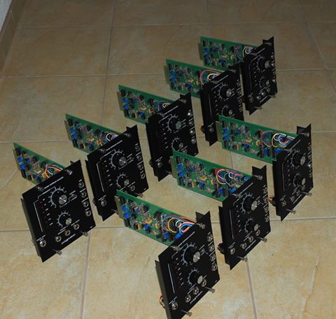

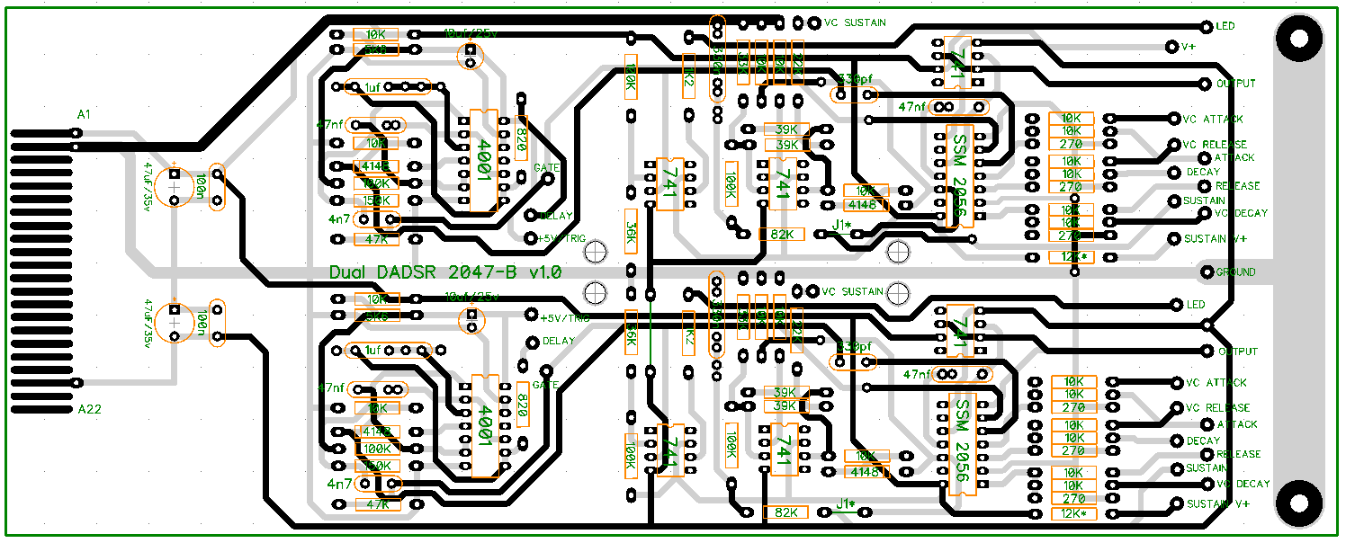

some DADSR ! replica
only weak spot of Polyfusion are original design of DADSR .. so I designed new ones based on SSM 2056.. and those are lightning fast :slight_smile:

and made my own design for VC DADSR with SSM 2056
and here it is

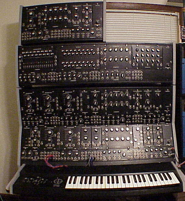

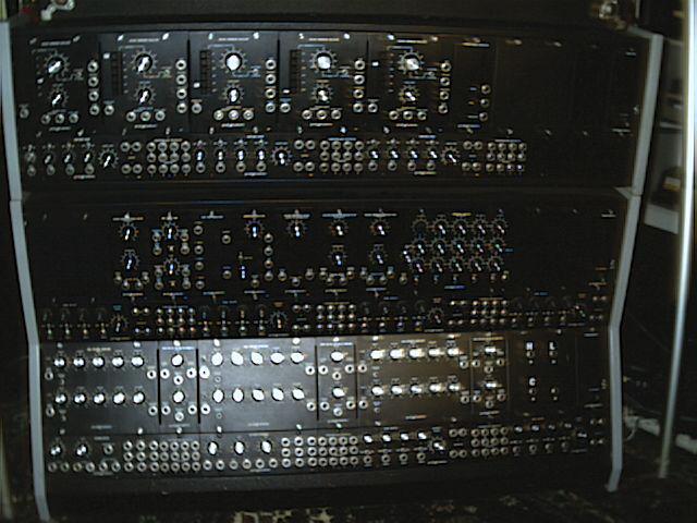

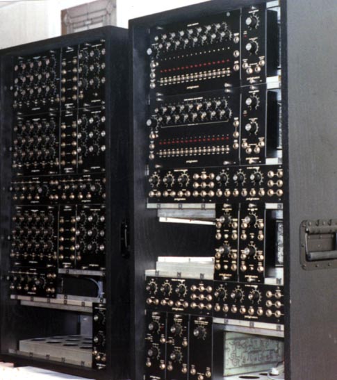

as far as Kevin told me .. made 11 of em and worked on like 15 of those monstrums .. he made one that is now owned by Deadmau5 and made some custom modules for Hans zimmer ..
he bought leftovers from PF somehow .. and made a lot from parts and leftovers .. he also sent me a doc on modules he made from scratch .. like VC DADSR based on CEM 3310, and some other stuff!

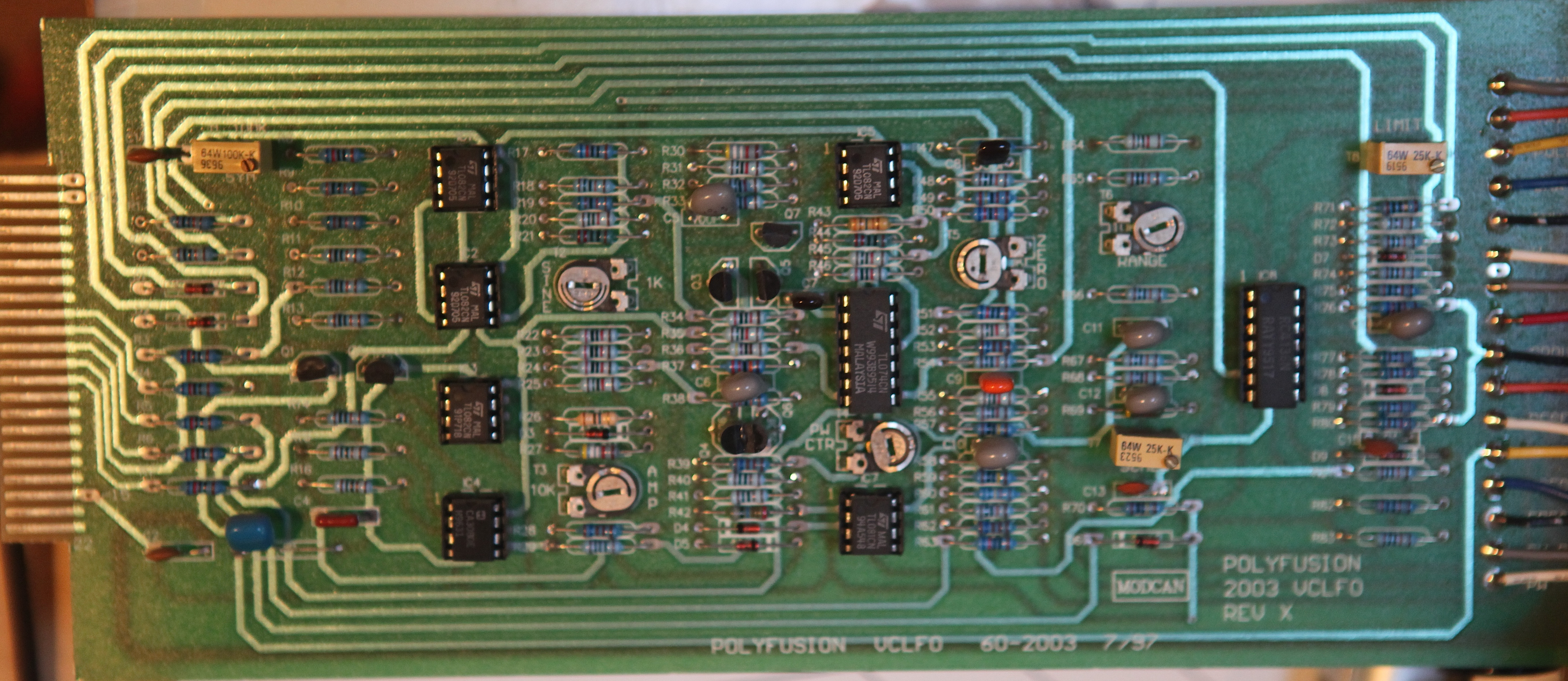

also Modcan made updated version of VC LFOS !! :wink:

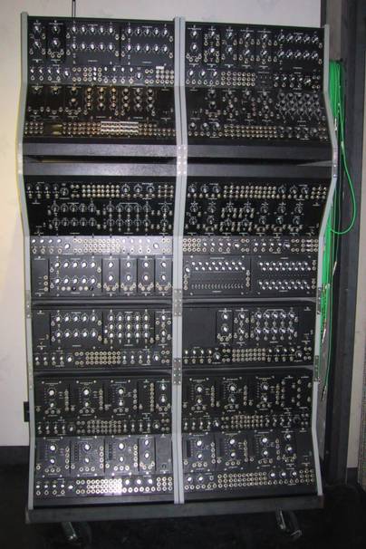

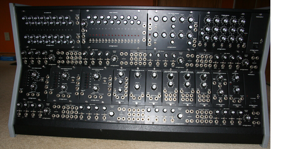

her are some monsters Kevin worked on !
all this pictures came from Kevins Hard disk .. he sent em all to me personally
ModCAN Polyfusion VC LFO !
I have original PF VC LFO and had MOD can one for long time .. also Bruce send me some docs on it .. bruce made great job ad improved it a bit .. polyfusion VC LFO is fantastic sounding VCO too!
demo is here ..
https://soundcloud.com/davidmorley/polyfusion-lfo
