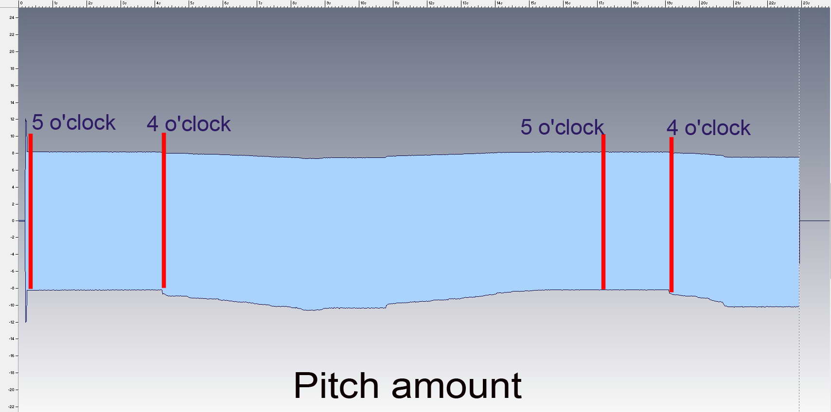

Hi Hans,
I did your steps also:
Yes is true. When the pitch amount is on 5 o’clock and you turn to 3 o’clock, There is between 5 o’clock and 4 o’clock no reaction. Suddenly on 4 o’clock the tune is moving up. But lightly in steps.
See picture and hear init preset.
https://youtu.be/qHrjt1ZBhCM
Greetings Luloop

I think it has to do with the new firmware…Not sure…
In any way. just keep calm and carry on and let see what moog says about it.
Regards Luloop

Just a update. Bernard and me where playing with a scope.
See video.
https://youtu.be/caZAkFodIus
Have a nice day!
Bernard, Luloop
