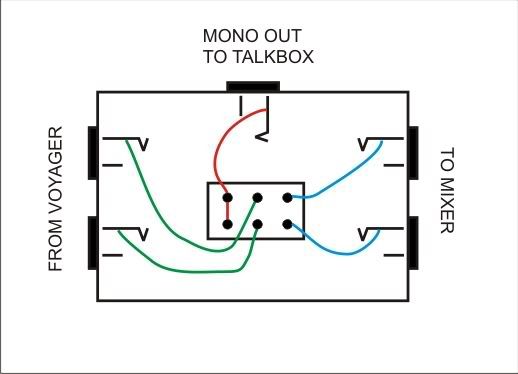

I have a couple of questions for Voyager users. The darn thing is dry as a fart, as you would expect, but I need a bit of “unsterile” for live. The Moog goes through the FOH, so I’m building a pedal board to filthy it up. Currently it goes through a Fulltone OCD, a Boss Space Echo thingy, and a Rocktron Talkbox. FOH gives it a touch of reverb.
My issue is that the Moog sounds a thousand times better in stereo. The talkbox is mono. Anyone have any idea how I can EASILY run a 1/4 into the talkbox so that when I stomp it, I get only the mono talkbox signal, and when I stomp it again, I get the straight STEREO signal from the Moog to the board?
My guess is I build a box with 2 1/4 ins to a stereo switch. Bypassed, the signal goes to 2 1/4 outs to the board. Kicked in, it goes to a separate 1/4 out for the left signal, and right goes nowhere (dummy jack for the right) The alternate left goes to the talkbox.

you could do it with a small cast aluminum enclosure, one DPDT stompswitch, and 5 x 1/4" mono jacks…
2 jacks on one end of the enclosure for cables from the moog, tip connectors wired to center lugs of the stompswitch.
2 jacks on the opposite end of the enclosure, tip connectors wired to the right side lugs of the stompswitch.
single jack on 3rd side of the enclosure, tip connector wired to both left side lugs of the stompswitch.
all grounds would be connected via contact with the metal enclosure
First, welcome to the forums.
Nice switch box.

One up each nostril! The mixer idea is great, but I’m a) extremely busy live, and b) extremely forgetful. Too many button pushes!
The box is exactly what I need! Thanks!
