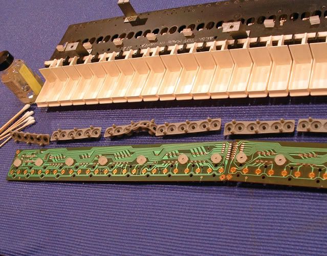

I’ve read that some of the early units shipped with j-wire keyboards, and the later ones had the rubber-plunger contact-strip keyboards. Mine is rev A8 with the latter. Here’s a shot of a spare keybed that I refurbished and sold recently - identical to the type currently in my OB-8:
The current keyboard works fine- no contact problems (yet), and I love this synth… but I’m just not a huge fan of the way this type of keyboard assembly feels.
Has anyone here ever swapped out the keybed in one of these? Looks like the scanning circuit in the OB-8 is similar to that of the OB-Xa (I think those were all j-wire, yes?), and so I thought if I could find a suitable five octave Pratt-Read keybed I might try to switch it out… Just curious if anyone has been through this, and if there is anything special to consider when looking for a replacement.

That’s a valid question, and I’ve been back and forth about this a lot over the years (I’ve had this OB since the late-90s). I guess I just prefer that heavier feel of the P-R keyboards (and whatever that keyboard is in my Mini - before they switched to the j-wire assemblies). I figure I could always pass the working bubble-strip keybed on to someone who needs it, assuming the transplant is successful :slight_smile:
It is a lot of work to restore the big keyboard assemblies! I’ve done a handful over the years - most recently overhauled the four octave keybed in my fvs, which feels fantastic now! If I can make the OB-8 feel like that, I’ll be thrilled. Just figured that since I have it all apart anyway, it might be a good time to give this a shot.

Yes I have one of the very early OB-8s and it came with the P-R keyboard (and also different voice boards with CEM3360 VCAs per voice) -
The P-R and later Panasonic keyboards are easily swapped - even the connector is the same…
Thanks, Doug - It’s reassuring to know that. Might even have a lead on a P-R action now too, thanks to Kevin
