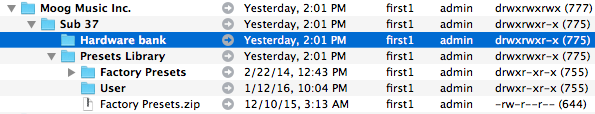

I wiped my Moog Music Inc. folder, to simulate a completely new install.
When a regular user installs the stand-alone application, the user has to authorize the installation by giving the administrator id and password.
Several folders are created by the installer in the user’s Library/Application Support directory. These items are owned by the installer, not the user. The top-level directory is also wide-open to the world (mode 777 for us old-time UNIX guys).
The ownership and permissions prevent the user from doing anything:
  • cannot rename folders and presets
  • cannot make new folders
  • cannot save presets into the folders
  • cannot save hardware presets from the machine into Hardware bank
  • cannot change or save preferences

The Presets Library folder contains Factory Presets for some other model (a Taurus I’m guessing). The Factory Presets.zip file is still there, too (see previous image).
This has been a source of confusion, and has generated many questions in this Forum: a Factory Presets folder that looks empty in the Editor, but which has lots of wrong-sized files when you look at it from the OS X Finder.
If the user already has a Sub 37 folder structure, the installer overwrites and changes ownership of the existing files and directories.

Mike,
Thanks for the detailed report. Our developer is checking into this right now.
Gil.
