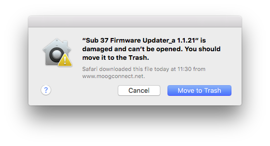

I first started “Sub 37 Firmware Updater_a 1.1.21” and got the following message:
““Sub 37 Firmware Updater_a 1.1.21” is damaged and can’t be opened. You should move it to the Trash.”
Then I tried “Sub 37 Firmware Updater_b 1.1.21” and that went fine. :slight_smile:
Same here:
Mac mini (Late 2014) OSX 10.10.5
Said “a” was damaged.
No problems with “b”.
