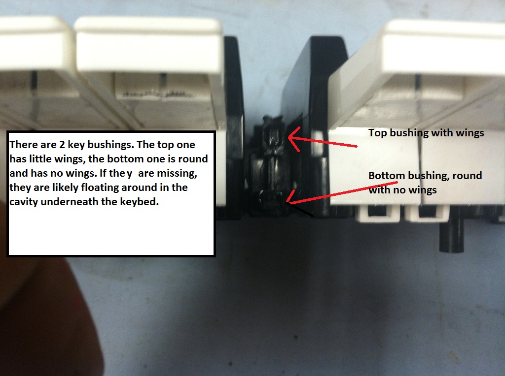

I think that is probably caused by the key bushing having fallen off the key post under that key.

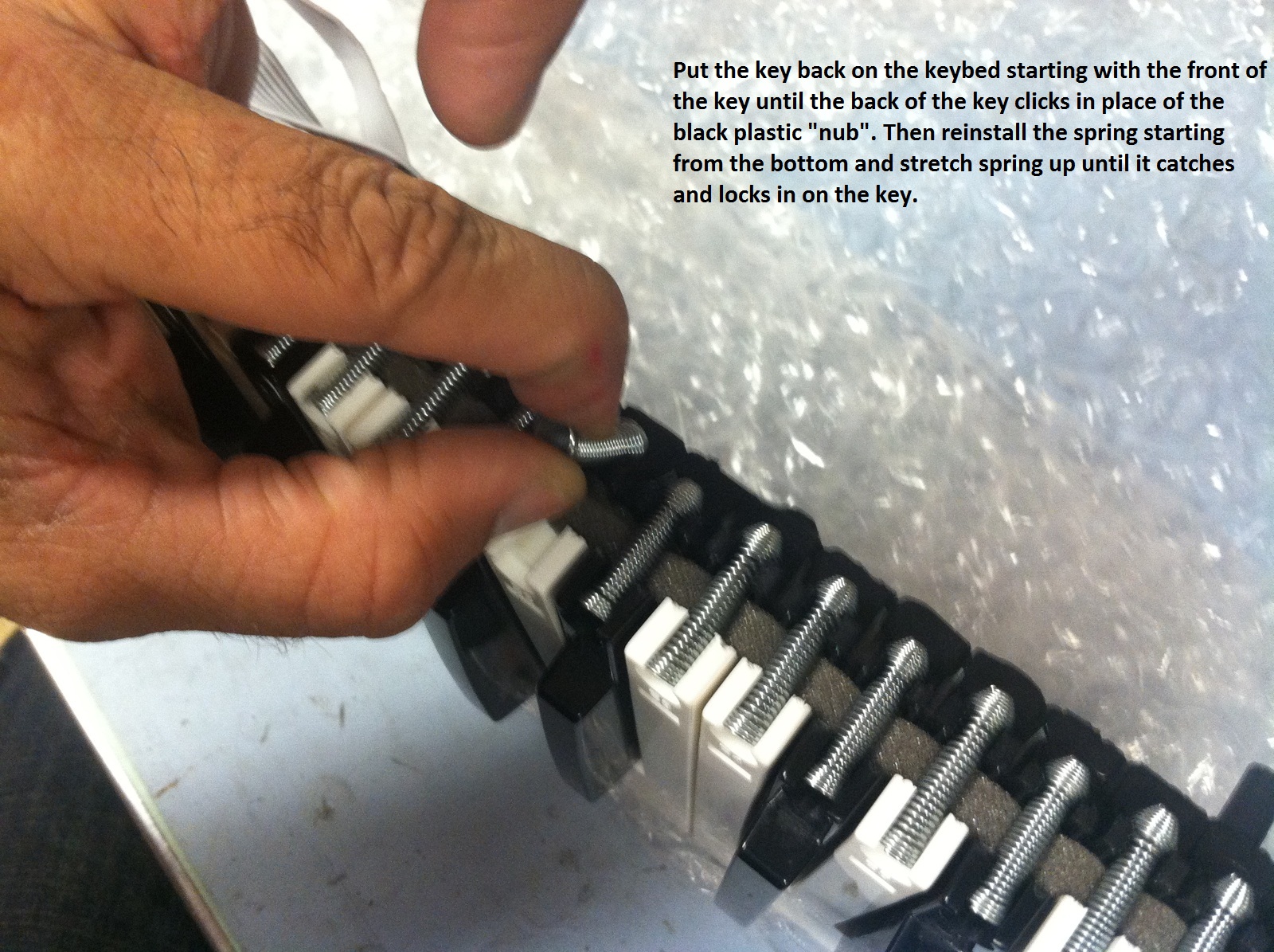

If you take the 6 black screws off the bottom that hold the keyboard to the chassis, you can then gently tilt the keyboard back to expose the inner workings of the key bed.
You will likely find a small black rubber “bushing” floating around under the keyboard. Remove the spring that holds the offending key in place, then gently push the key forward and up (from the back) until it clicks off of the post it is attached to. Replace the missing rubber bushing, reassemble and you should be good to go!
I’ve attached a few pics that might aid in the process!
