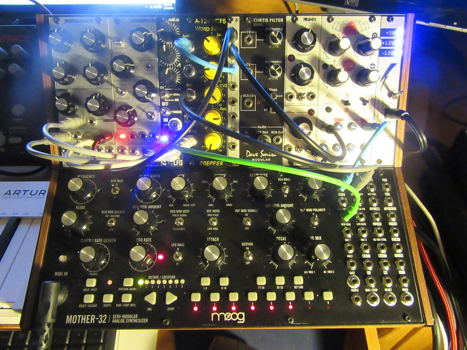

OK a Pittsburgh Modular Waveforms multi-oscillator worked perfectly plugged into the external audio jack. So now my Mom has at least two oscs and can be more because the Waveforms can output more than one osc at a time. I need to get some stackable cables. Here is a picture of the rig. Everything plays nicely with the Mom.
