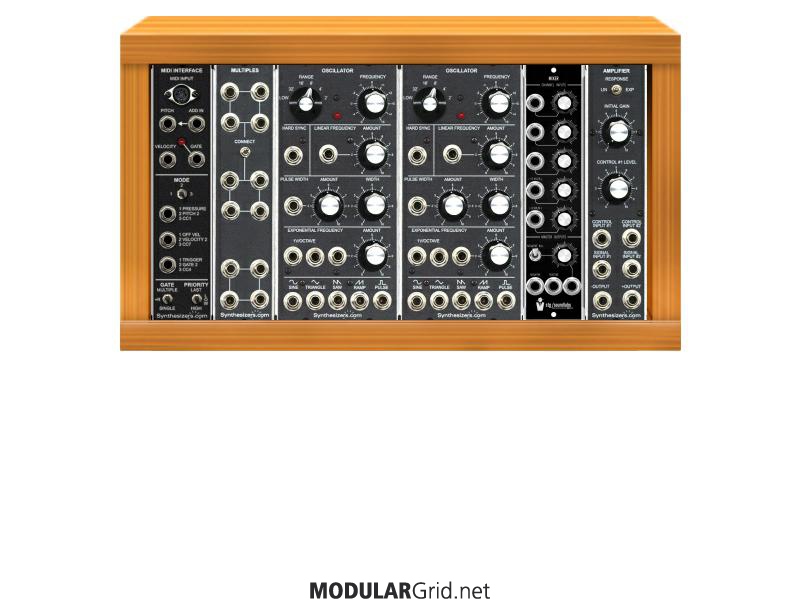

So to get you more immediacy and satisfy your needs, I’ve attached a small dotcom based system: Midi interface, mult, 2 oscs, the stg mixer, and a vca so you can articulate them.
You could probably do without the mixer and sub the dotcom osc aid, but considering the ability to mix the oscs, to get the Moog style distortion (cp3 clone) and using them as midi controlled LFOs, that mixer is especially nice. The VCA will allow you to articulate them as a voice or will let you drone away, though that can also be done with the stg mixer (minus the articulation). I wanted to throw in a 1u filter like the STG Post Lawsuit LPF just so you would have a complete voice.
These could be put in a dotcom box 11 or their small 8u tolex portable cabinet. Or there is a forum member here who could build you an enclosure if you want to get some modules like the moslab with the deeper pcbs.
Modular seems to complicated (and expensive for my needs) Probably the mother 32 or even two of them would do me fine. I just need to be able to make drones (2 oscillator thick drones) and be able to play keys at the same time.

You seem like you have your mind made up, but I wanted to mention two things. First, the system I mentioned to you was about 1084 dollars. Add a rack frame and a power supply and you are in the price territory of 2 Mothers (maybe 20-40 bucks more). As far as modular being difficult, I don’t agree. When you physically route signals via patch cables, it gives you a better understanding of synthesis because you can plainly see the signal paths. I find this tremendously easier than memorizing the complicated nuances necessary to access certain off-panel features via an OS. But I always encourage people to buy more than they need because it gives them something to grow into. There is no better way to learn in my opinion. I would rather have the option of choosing my own modulation sources to achieve PWM than to be stuck with built-in limitations. For instance, using a saw or a randomized wave to get PWM or combining various waves to get it make for more interesting patches.
