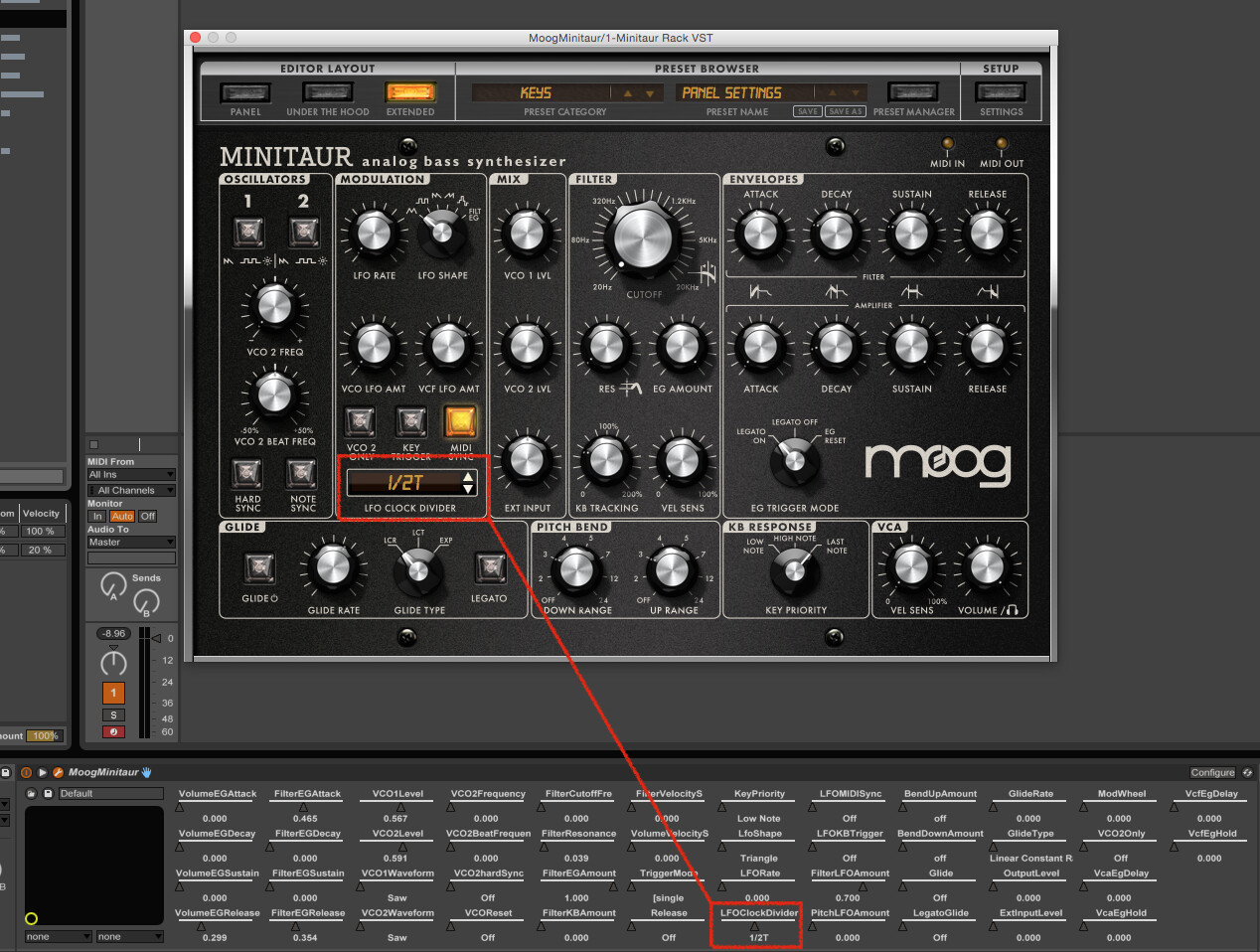

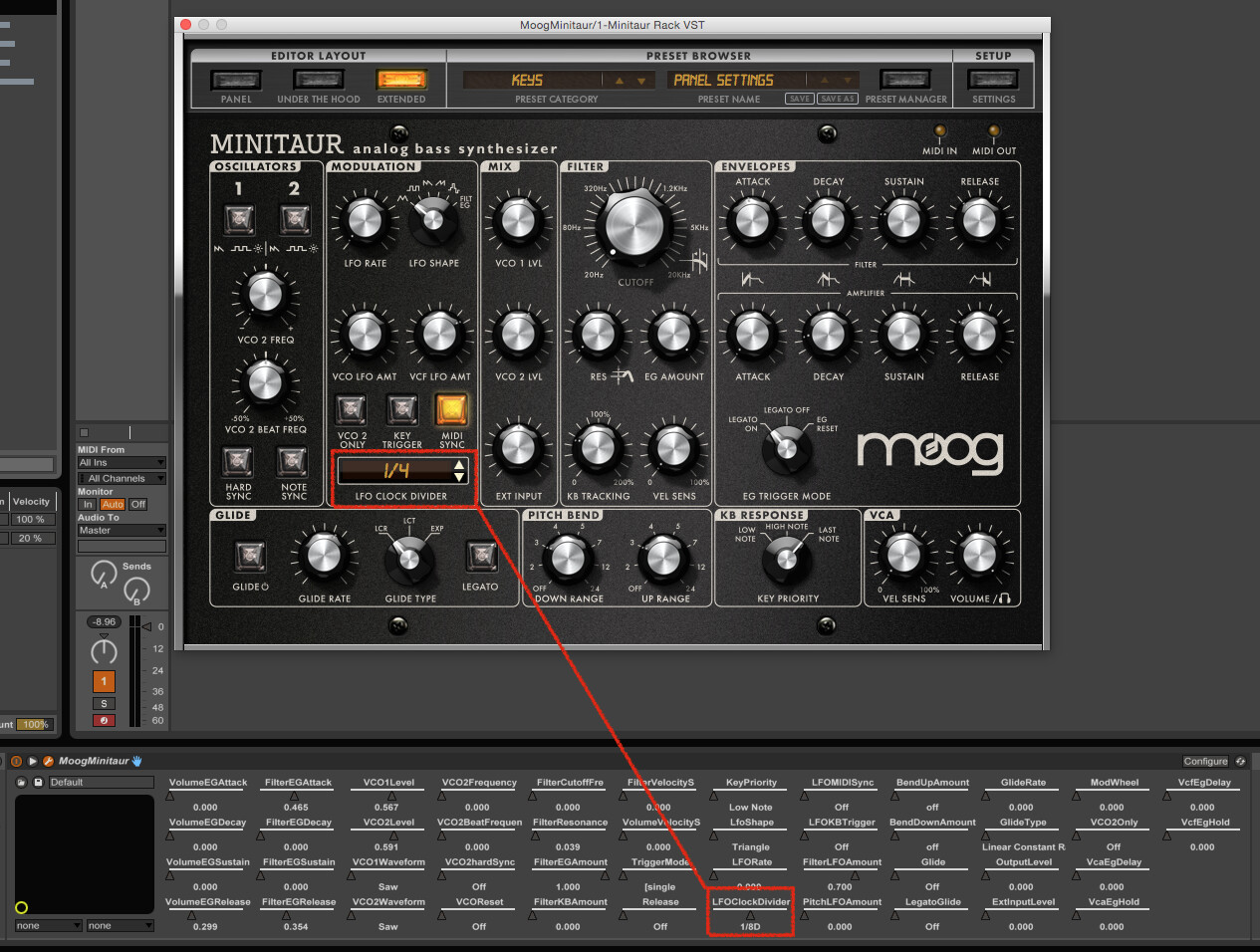

There is still a bug with the syncing of the LFO Clock Divider and the display in Ableton. This then shows up incorrectly on Push. This would then still show up incorrrectly on any other controller that can display the value. More specifically, the problem happens from the transition form 1/2T to 1/4. In Ableton the slider shows 1/8D. This is then off from this division the rest of the way to 1/64.

Should be fixed in 3.2.0b12.1
Will you be able to confirm ?
It is now fixed in the v3.2.0b12.1 editor. Works like a champ. Thank you!
