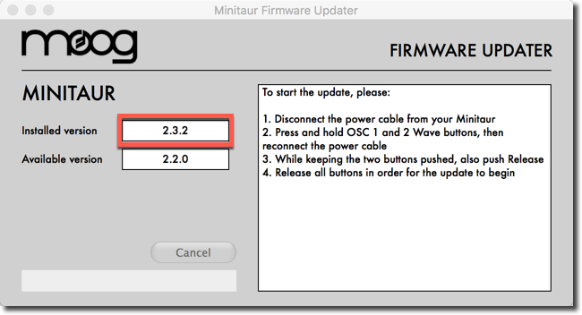

Strangely the firmware updater now thinks I have a newer version than 2.2.0RC11 … see attached.
The wrong number is due to limitation in the way firmware version numbers are translated in this GUI. This is not supposed to happen to end users, installing release/official versions, only when installing beta firmware.

Hi.
I have a wrong version issue in automatic updater too.
the Editor indicates that I have 2.1.14 firmware version
the Automatic Updater tells that it’s 2.2.4.

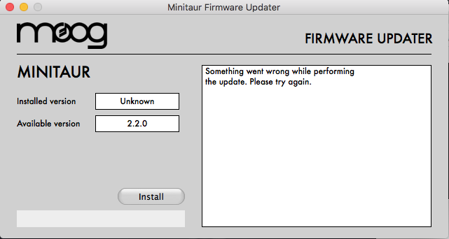

UPD: And it doesn’t update the Minitaur, which is connected directly to my Mac via usb cable.
it tells:
Erasing…
Installing new firmware…
then stops and tells: Something went wrong…
UPD2: I did Manual update and it seems that the firmware has been updated then.

This type of mismatch may only show up for beta testers, who’ve been using beta versions.
