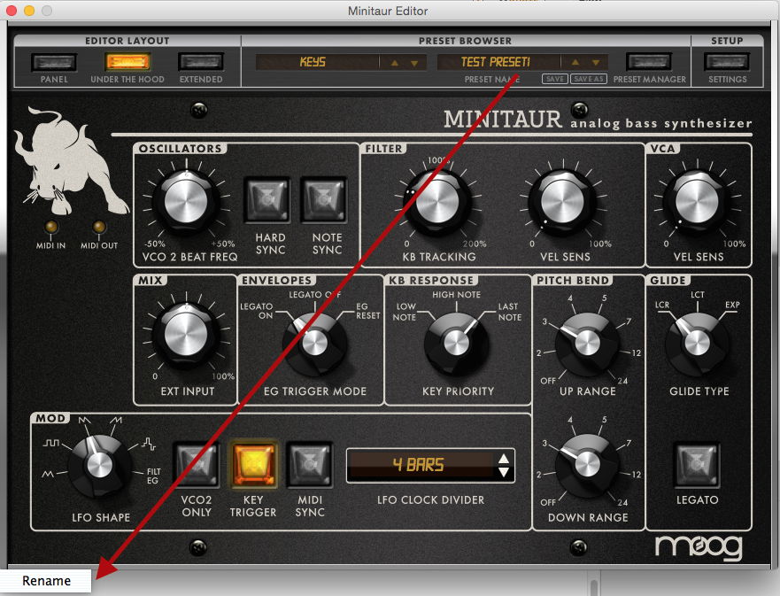

Standalone Editor: two bugs with presets management page.
  1. ‘Rename’ button appears in the left lower corner of the editor. (I think It has to be right over the current preset name)
  2. The Editor doesn’t save presets to default folder after install.
Mac OS X 10.10.5 (14F2009) Yosemite
Editor version: 3.2.0b6
MT Filmware 2.1.13
Actions:
  1. Modify any given preset
  2. Right click the Preset Name field - you will see the rename button in the lower left corner
  3. Rename the preset
  4. Press Save As…
  5. It will attempt to save the preset to user’s home directory instead of default directory (which is ~/Library/Application Support/Moog Music Inc./Minitaur/Presets Library/User).
  6. If you press Save As and navigate the Editor to its ‘default’ folder (~/Library/Application Support/Moog Music Inc./Minitaur/Presets Library/User) it will save a preset and then ‘remembers’ this folder for subsequent saving.

“Rename” issue confirmed and reported.
