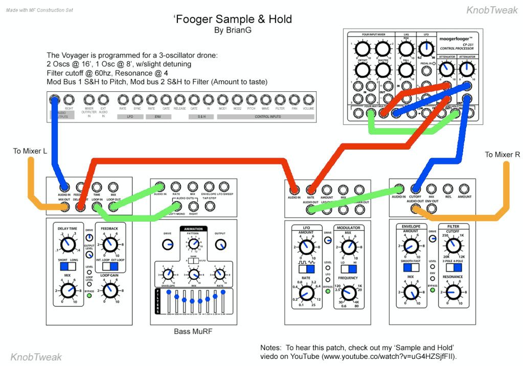

Here’s an example of a trippy space noise configuration done by my buddy Brian. Among the many connections, it places a BMuRF in the loop of the '104:
Check out the YouTube link to hear it:
http://www.youtube.com/watch?v=uG4HZSjfFII
Experimentation is the key. Grab some patch cords and have a go at it. I’m sure you’ll be pleasantly surprised at what you will come up with.
Oops! Good catch, Mark! :smiley:
