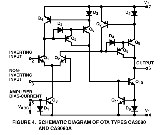

Figure 4. shows a schematic of a CA3080-style OTA. Note that all diodes shown are really diode connected transistors as in Fig. 3A. Note also that the two PNP mirrors are somewhat more complex than the NPN mirrors. This is because it is more difficult to make high gain PNP transistors on the same substrate with NPN, and a Darlington PNP is required. Again, note that no resistors are required.
If we now redraw the circuit replacing the mirrors by symbols to represent mirrors, it is relatively easy to see how the OTA works. Figure 2 shows this simplified schematic.
A current IABC is blown into pin 5, and is sucked via mirror W from the input differential pair. Let us suppose for the moment that the input pair are perfectly matched and connected to a voltage midway between V+_ and V-. Let the supply voltages be +12 and –12. The current defined by IABC is now divided equally between Q1 and Q2. As we will see shortly, the output of the amplifier is a current. To develop a voltage let us assume that there is a 5K resistor to ground on the output. Assume that the amplifier bias current, I, is 2 ma. Half the current I, 1 ma., is sucked via Q1 from PNP current mirror Y whose output blows an equal current into NPN current mirror X, which sucks an equal current from the output. Half the current I, 1 ma., is sucked via Q2 from PNP current mirror Z, which blows an equal current into the output. Thus, current mirror X is sucking 1 ma, and current mirror Z is blowing 1 ma., and the net current into the output is zero. The voltage at the output is zero.
If we apply an unbalanced drive to the input pair, all of the current will either go through Q1 or Q2, depending on the polarity on the inputs. The output in this case will be either 2ma blown into 5K (+10) or 2ma sucked from the 5K or –10 volts. Any injected current can be turned into alternating + and - currents that are equal and converted to equal + and – voltages. If instead of a resistor, we run the current to the summing node of an op amp connected as an integrator (cap from output to minus), the output of the op amp will ramp up and down with equal slopes, and we can make a current controlled triangle/square wave oscillator. Since it acts as a variable resistance, the OTA is potentially very useful for voltage controlled oscillator, amplifier and filter applications.
