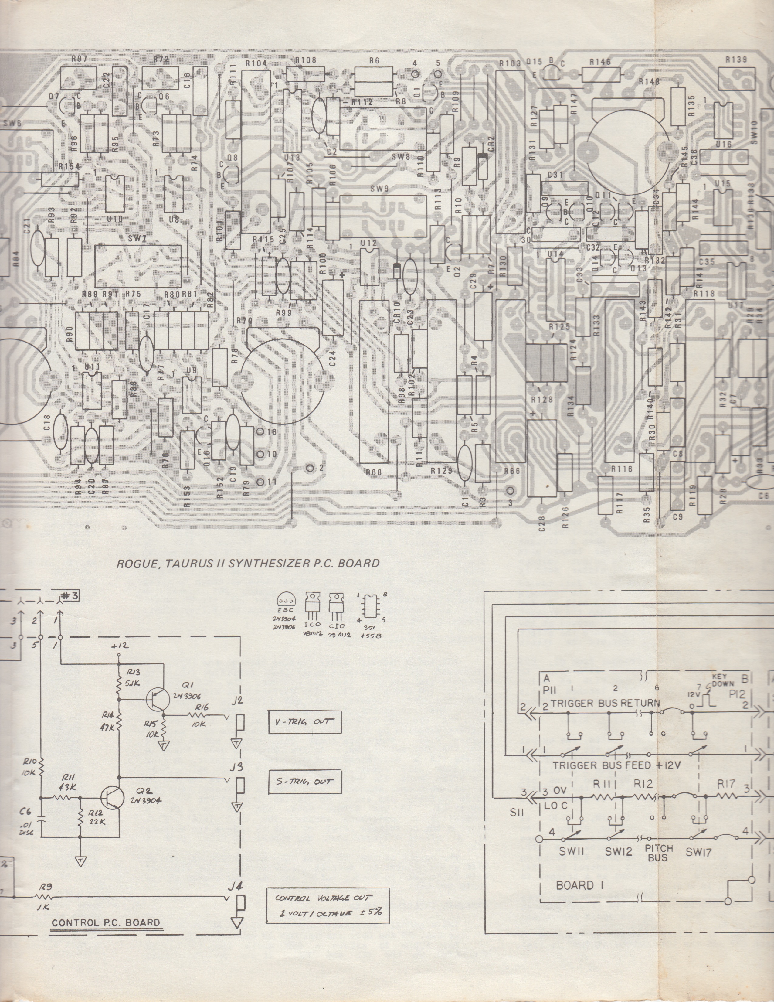

here is the technical service manual for rogues and taurus 2s, circuit description, pcb layout, and troubleshooting. i have not seen this anywhere online so i figured id scan my copy and upload

thats just the cover, the entire thing is in a zip at that link, and that google search link has none of these pages
more
more
more
