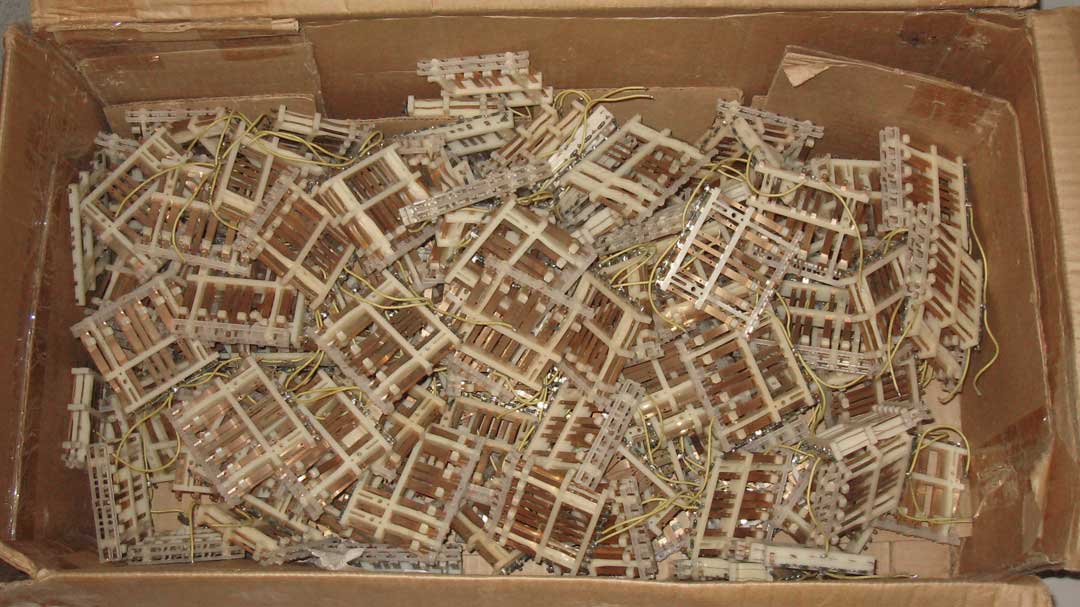

I don’t recall what the Rogue contacts are like, but if they’re the same as the Source, I have a big box of them.

They look about the same as the ones I have…
