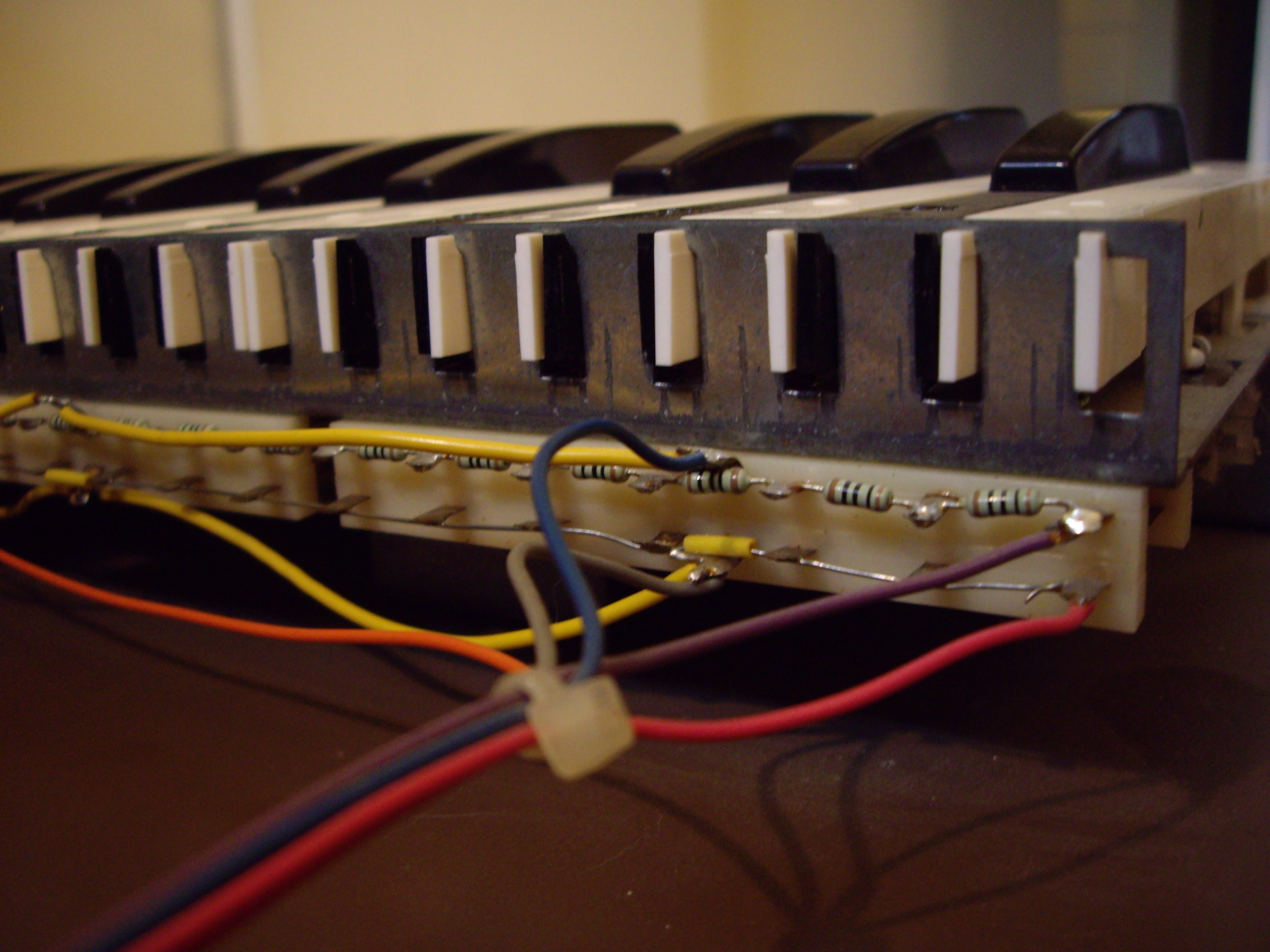

i’ve examined the chain of resistors near the keys (see attached picture)
the soldering between the contacts seems okay and none of the pins are touching each other that shouldn’t be.
do i need to replace one of the resistors?
No one can say from a photo.
You need someone to check it with a meter.
Fwiw, I have a big box filled with those contacts.
Many with resistors already installed, some not.
But you should find out what the problem is before replacing any parts or adjusting trims.
