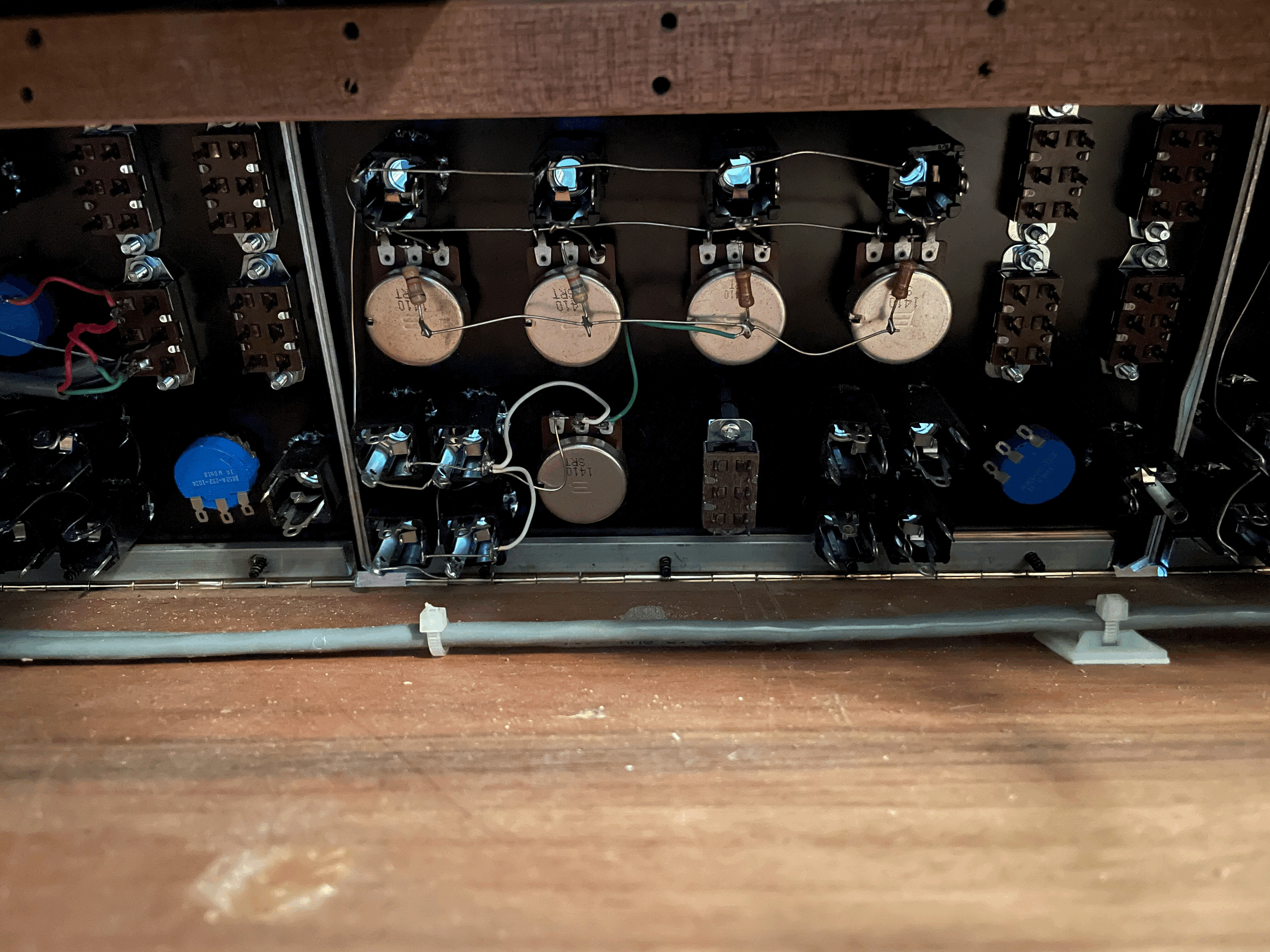

Hi All , I just bought an old Modular , which has been made up of all kinds of bits including 2 Mini Moog OSC banks , I am going to make 1 or 2 new top cabinets and start to add to the system using Moon and Other 3rd party modules can anyone help with the Cp3 I have , I do have much info and I am not sure what original in them . I have 4
I can see there is nothing connected to the Click Filter which is how I found this thread via a google search
Isn’t this the back side of a CP3**A** frontpanel?
And where is the pcb?
The circuit of a CP3A does not provide a click filter. But you can add one by providing a switch and a 1µF capacitor between input sum and ground. See service manual. But at least my CP3A clone works fine without.
I don’t have the PCBs ? these seem to work and a line level mixer without them what’s it the PCBs did ?
I see you have made some do you sell them ?
Andy
The switches of the module I can see on your picture are not connected to anything. Seems that they have never been connected to anything :open_mouth: 4 input channels seem to be passively mixed and provided at the outputs. This seems to work anyway.
A lets say complete CP3A does an active mixing with opamps incl. amplifying!!! Two outputs are phase inverted, as engraved on the front panel. You need a pcb for this, as you can see with my clone. Has Moog ever sold passive mixers? I don’t think so, as the swiches are provided, but not connected. So what is this here?
