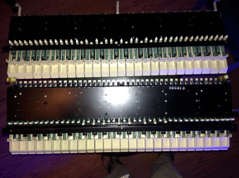

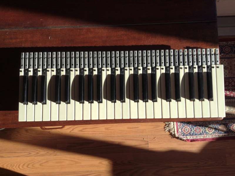

ok, Iv got this all figured out now,
that is the entire pratt reed keyboard.
You will need the Optikey system and a metal bracket to mount in your moog.
