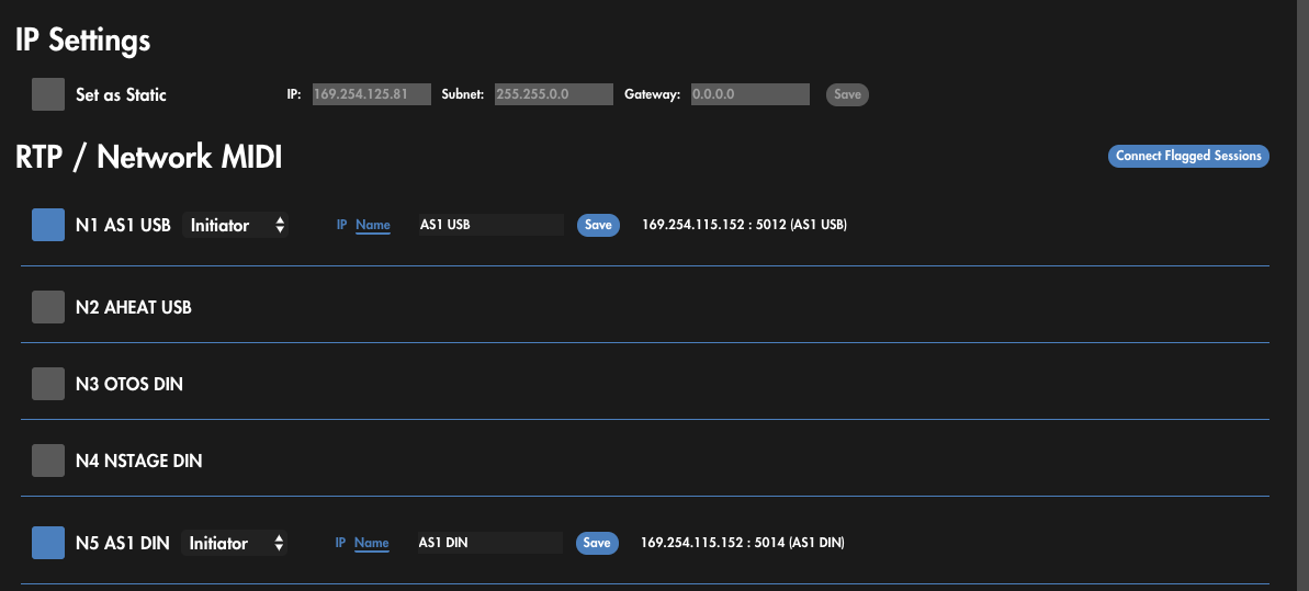

On the other hand, I have a similar setup with a Toraiz AS-1 and REV2 connected to a MIO XM and using the soundtower software. In this case everything runs smooth and fine, also when previewing presets from SW to HW and all that stuff…

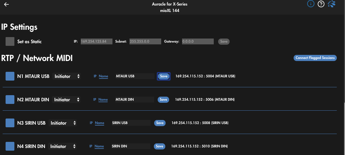

This is the way everything is set up:
  • midi cable from DIN output of MIO XL to DIN input of Moog synth, this is for receiving MIDI note data and other simple MIDI commands.
  • USB from MIO XL host port to USB of Moog synth, this is for the connection of the editor / AU software and thus communication between HW and SW.
  • mio XL is connected via RTP to my Mac mini.
  • everything is routed via the iConnectivity Auracle software and Mac’s MIDI-studio as how it should be and in the very same way my successful setup with the AS1 and REV2 is done.
