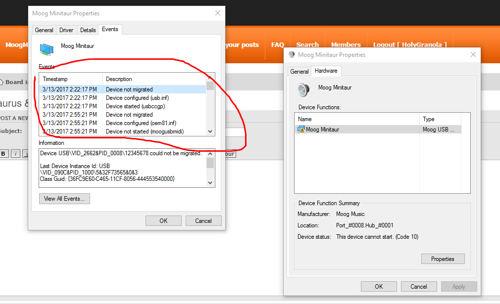

So I just received a moog minitaur and after a couple days of trying to figure out how to get this thing to work I’ve come to a dead end it seems like. I have all my drivers installed, The correct sized audio interface, all my inputs are correct and for some reason it is not showing up on my external instruments tab, or anywhere in ableton for that matter. rendering it useless. My computer seems to be recognizing it through USB but when I click on it to observe the properties I am told that there is a driver error. I have uninstalled and reinstalled the drivers and keep getting the same issue. I am close to just returning this thing unfortunately. Does anyone have a clue how to get this thing to work? I am running ableton live 9, using a scarlett 2i4, and I have an MSI GL72 (pretty sure thats the name) , I am also using the latest drivers for the minitaur.

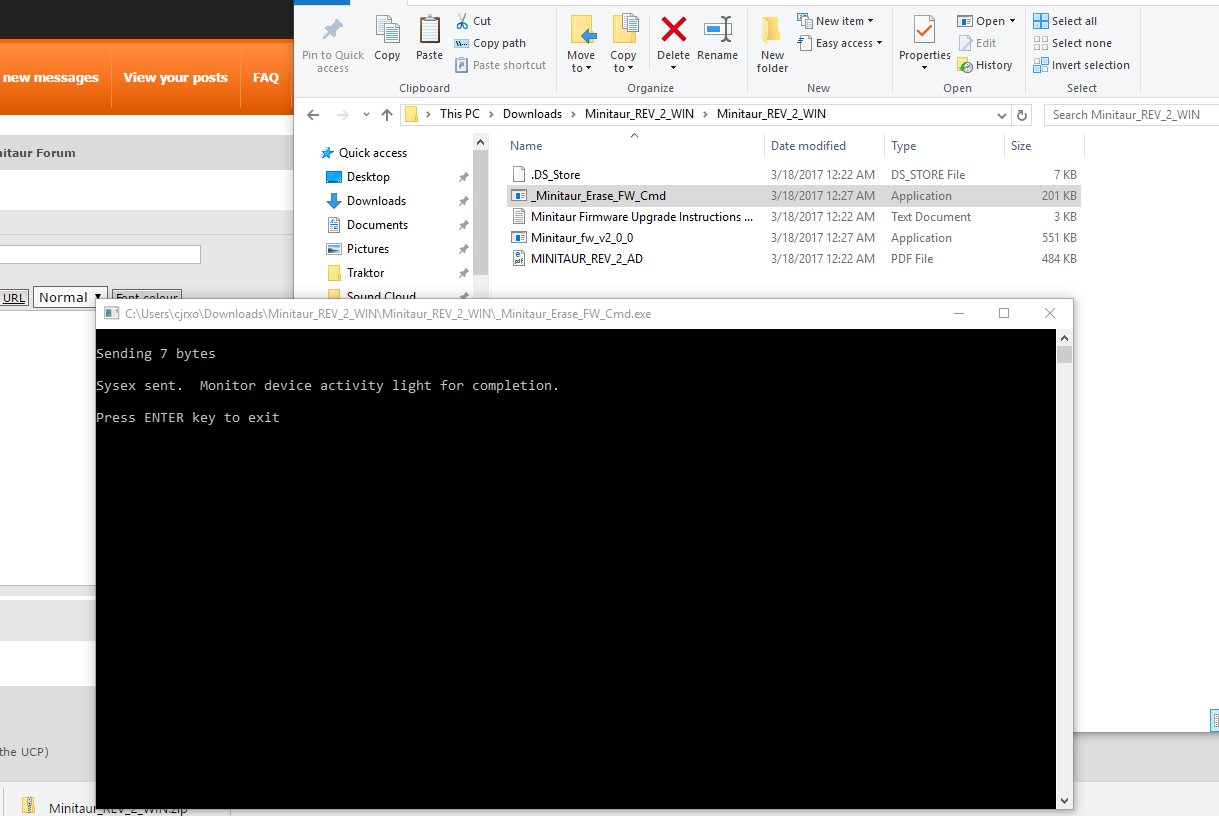

On top of this, when I now try to delete my firmware using the erase command I don’t even see an option to select my synth.Can anyone point me in the right direction so I can actually use this awesome piece of machinery?

Actually got this issue fixed! I needed to uninstall the driver that i downloaded from moog and use the generic windows USB driver!
