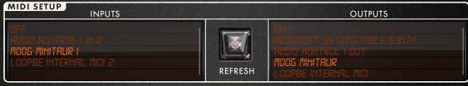

I have a problem with connetions between my minitaur & ableton.
When my Editor is open I cant control any automation in ableton and i didnt see it in external instruments, but when i closed editor and restart ableton it reappears in ext. instr.
And when able is open none of the knobs does not respond in Editor.
I cant save any presets.
please help.
thnk ya.

I can’t get any automation in Ableton at all though, regardless of whether the editor is open or not. If I have only the editor open I am receiving midi messages in both directions, meaning I can adjust the hardware and view changes happening in the editor, and can adjust settings in the editor and have them affect the hardware.
When I use Ableton and set the Minitaur up as an ext. instrument I appear to be getting midi in only one direction (to the hardware). I’ll record a midi clip which records all the notes played from my midi keyboard, and I am getting sound into live, I’m just not getting any automation messages being recorded if I adjust any of the setting on the hardware.
This makes me think there’s a problem with the settings in Ableton? I’ve tried changing the midi preferences in Ableton and currently have Minitaur input: Track=OFF, Sync=ON, Remote=ON - Minitaur output: Track=ON, Sync=ON, Remote=ON. If I turn the Minitaur midi input Track to ON, I then don’t have any control of the hardware anymore (or the range of the knobs have all been greatly reduced).

Just as an update I tried the Minitaur on an empty midi channel setting the midi in and midi out to the Minitaur. Using this method I was able to track automation changes when recording which means I am receiving midi back into Ableton, I just can’t get it working as an ext. Instrument.
I am also having the same problem. I cant use Ableton Live 8 and the Editor together. If I open the editor on its own it works fine and shows that its Firmware Version 2.0 . But then if I open Ableton Live I cant select the Minitaur within it. If i open Ableton 1st then the editor nothing works in the editor and where it should say Firmware Version 2.0 there a “?”.
What I am having to do is open the editor on its own, select the patch I want to use, configure it how I want it (monitoring via the headphone output) then close the editor. Then open Ableton and use the Minitaur normally. But If I want to change the patch I have to go through the whole process again.
