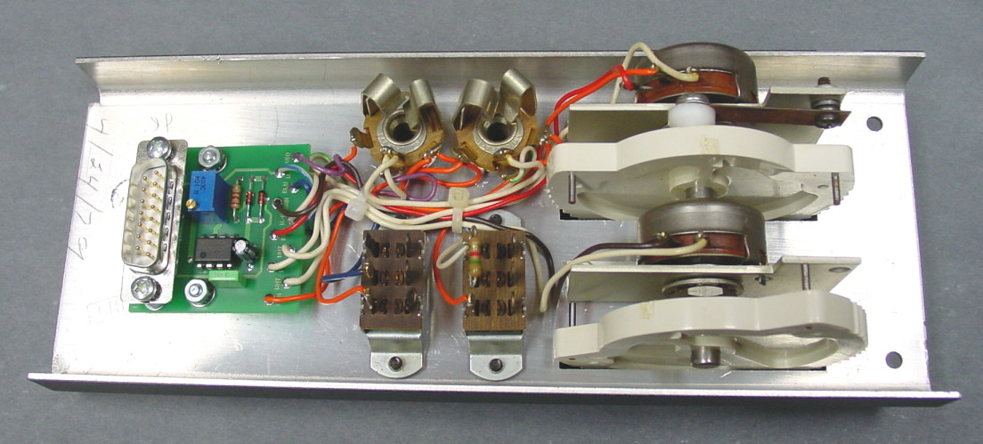

I’m using this board for the Minimoog upgrades. The good thing is - there’s a small noise reduction for the pitch wheel pot, a buffer and golden pins of the connector. The bad thing is - you have to replace the panel connector too.
Have fun,
Rudi
