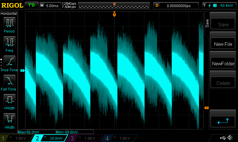

I have connected a scope and see all the different wave shapes looking good just before the Mixer block. I’m using a saw wave for testing. The saw wave seems to get a bit noise once the signal enters the MIXER block, after it has passed the 330ohm resistor. I’m not sure if the saw wave should look this noisy on my scope so I"m looking for a second opinion.

Here is what the OSC1 SAW looks like just after it enters the MIXER block: ( just after the 330ohm resistor )

I’m include some screenshots of my scope. It sounds like I"m missing all the high end, confirming the sine wave I see on my scope when I connect it to the main audio out.
Here is the saw wave before the MIXER block ( yellow line ), and the after the SAW exists the VCF filter block ( blue line ):
