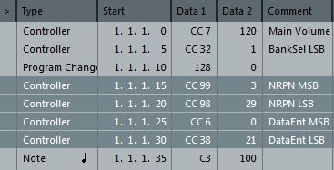

If you’re using the NRPN C99/C98/C6/C38 thingy to control the sync clock divisions, try spreading out the time between each controller to give it a bit of breathing space.
It is possible that there may be MIDI congestion and will mysteriously fail if too much is going on at once.
See the below pic where there’s a gap of 5 between one event and the next
