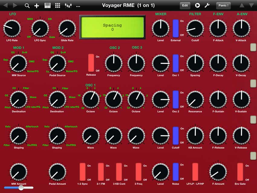

The template I created has about everything from the RME that has MIDI CCs assigned to it on a single map. It’s a bit cramped but you can change that yourself of course.
The knobs on the iPad screen have a resolution of 128 steps, but you can define per controller the resolution for finetuning when double tapping on that controller: most of the knobs have a 2500 steps resolution, but again: you can change it to your own taste (the 14 bit resolution of most Voyager knobs allow a resolution of up to 16384 steps).
As you can see on the picture: I followed as much as possible the layout of the RME, except for the LFO and the master volume row. The small slider in the lower left corner is the mod wheel controller, to be able to set the MOD1 amount.
The four gray dots on the right side are buttons that trigger a MIDI note so you can edit and hear the result from your lazy chair.
MIDI out channel of this template is set to channel 1, but you can change that of course.
