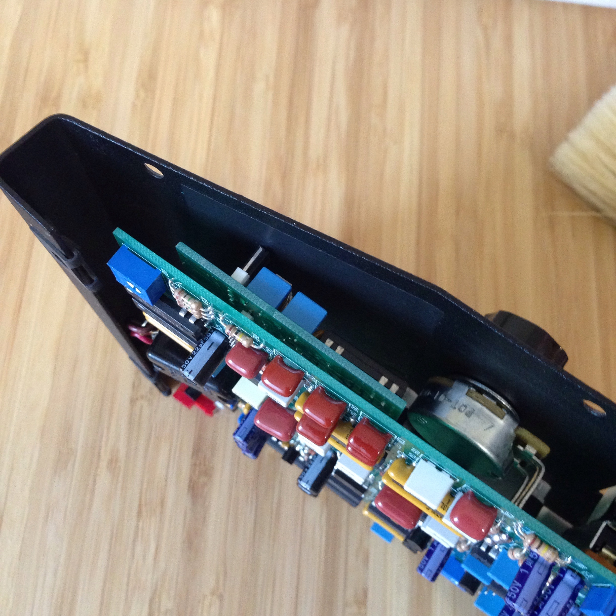

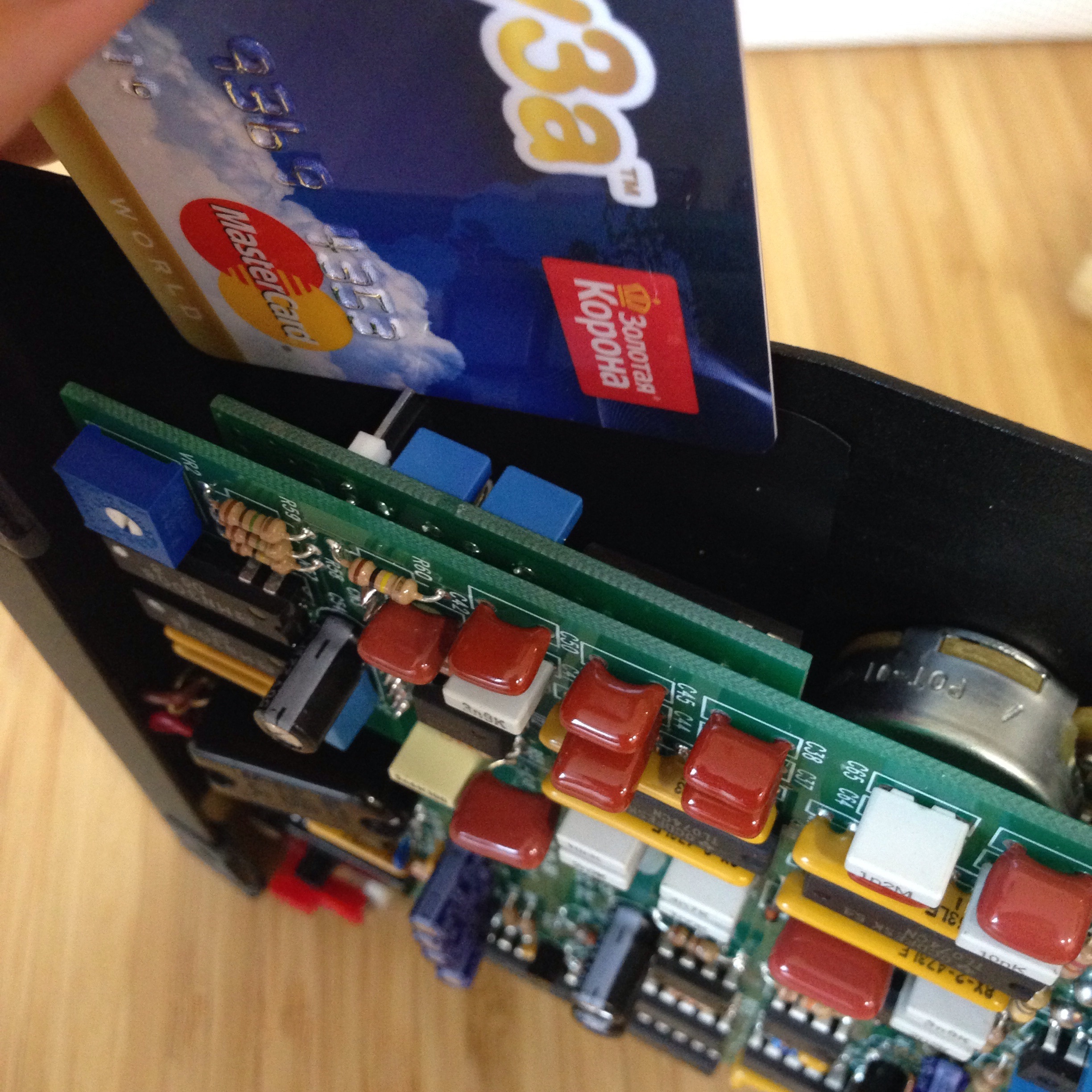

Could you show or explain in more detail what kind of little motherboard should be isolated?
You can’t see it from the bottom, only the side.
There is a second circuit board attached to the motherboard, and there are jumper pins that extend from the top that touch the top of the chassis and short out. Even if it looks like they don’t touch the top of the metal, they get close enough to create a short (electrons can jump a good distance, thanks to Einstein’s revelation) Those pins must be clipped, insulated or covered to keep the delay from shorting out. Paper is only a temporary solution as it will degrade away. Electrical tape, or clipping and covering them in the answer.
Oh, thank’s a lot!

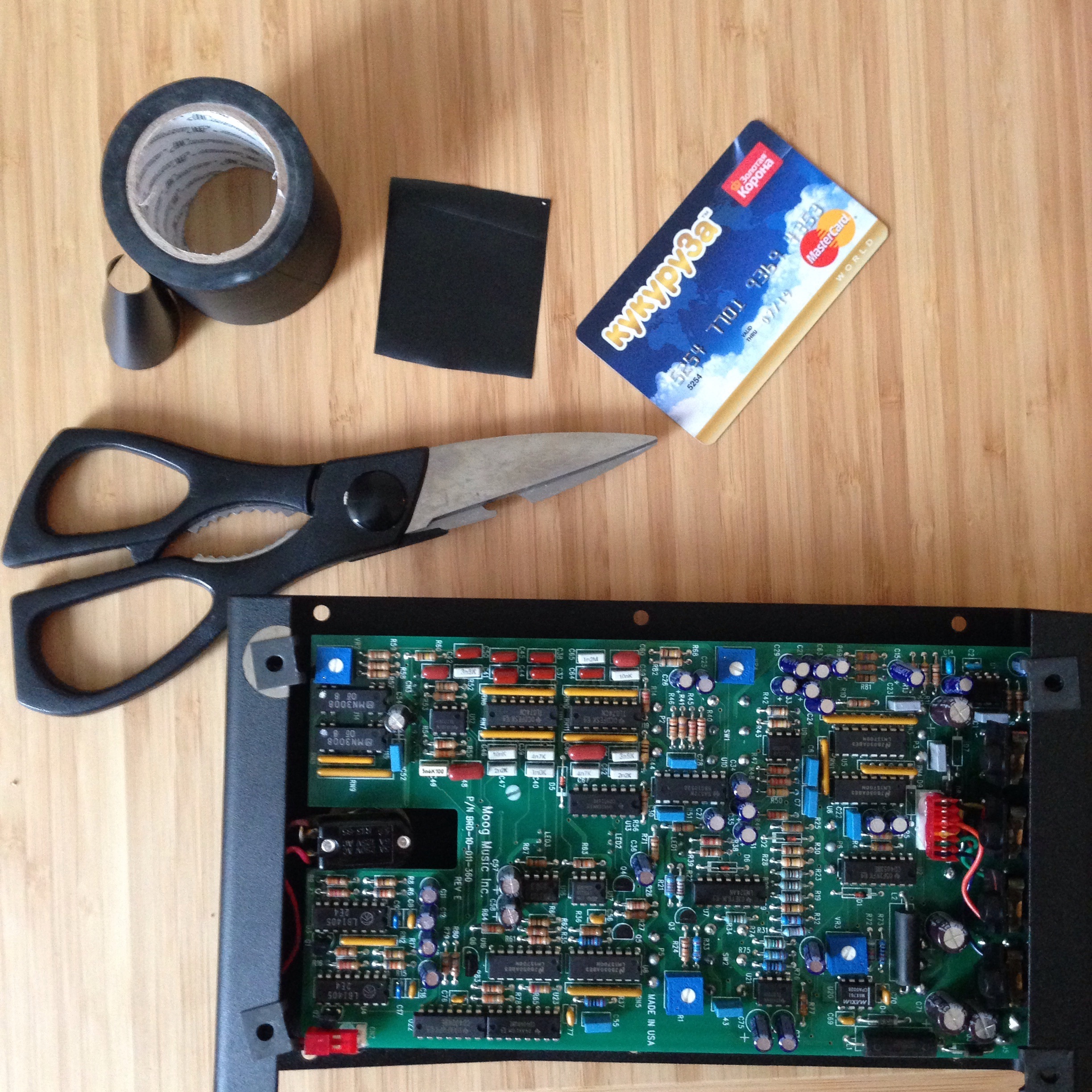

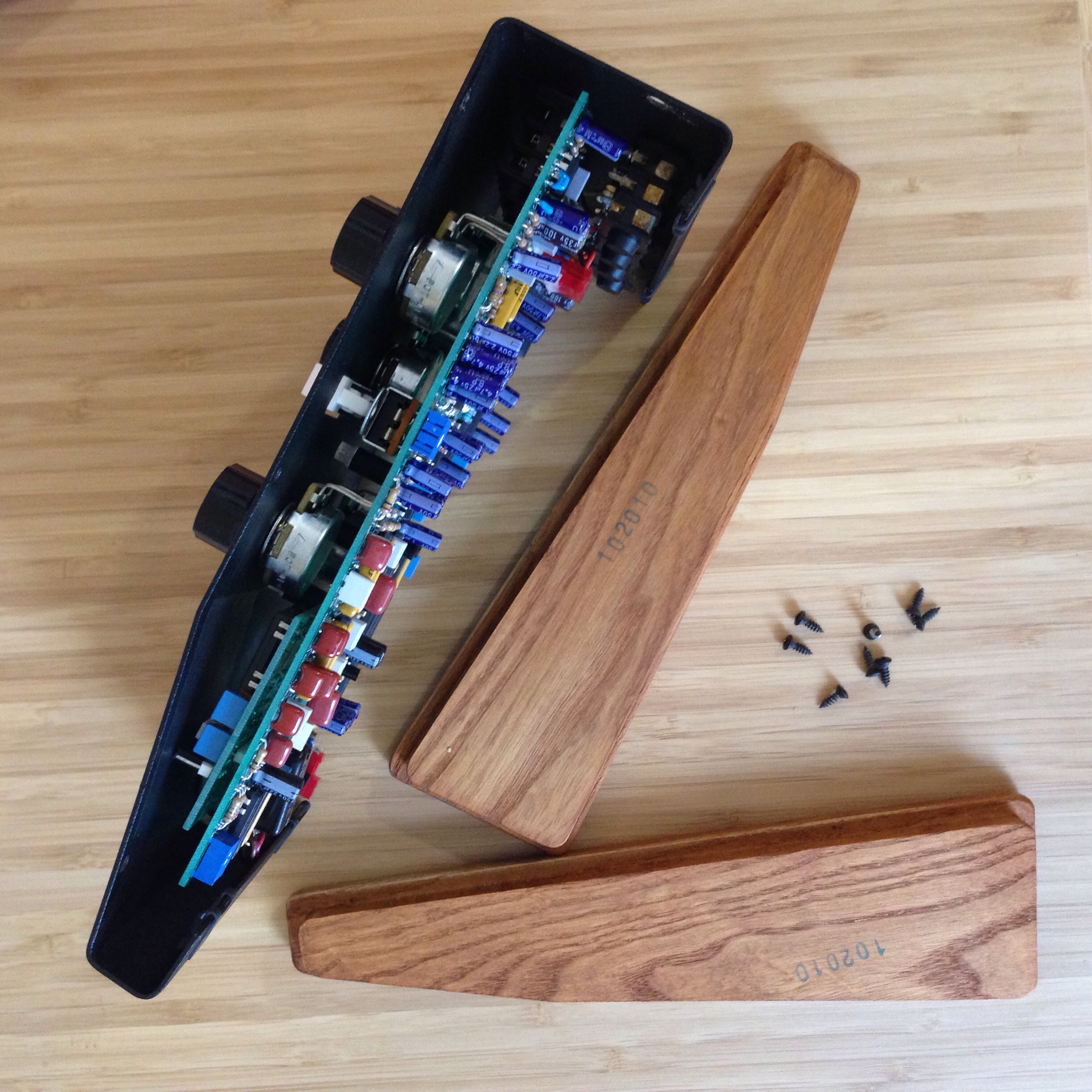

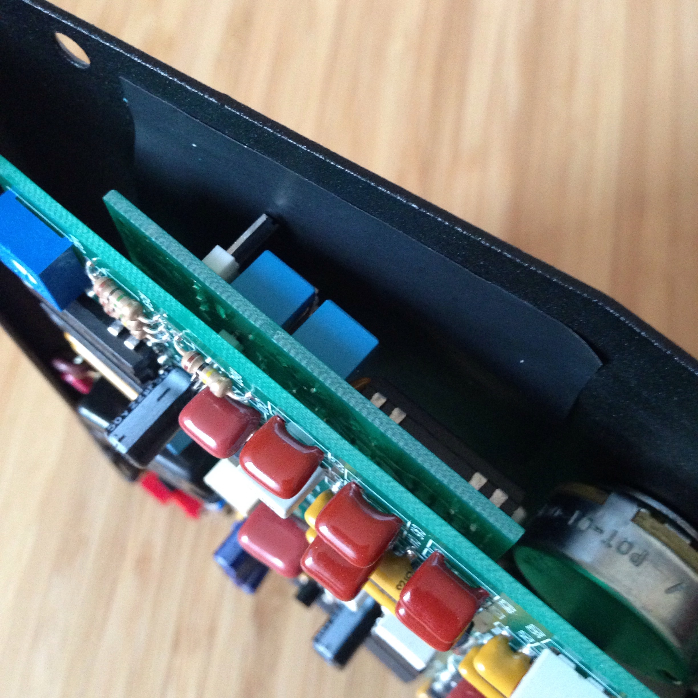

That’s what I did now:
And that’s what I got:
Niiiiiiice!
I’ll examine mine soon, thanks for posting the pictures mate :slight_smile:
You may want to blur out the number on your credit card next time, before you post it on the Internet.
