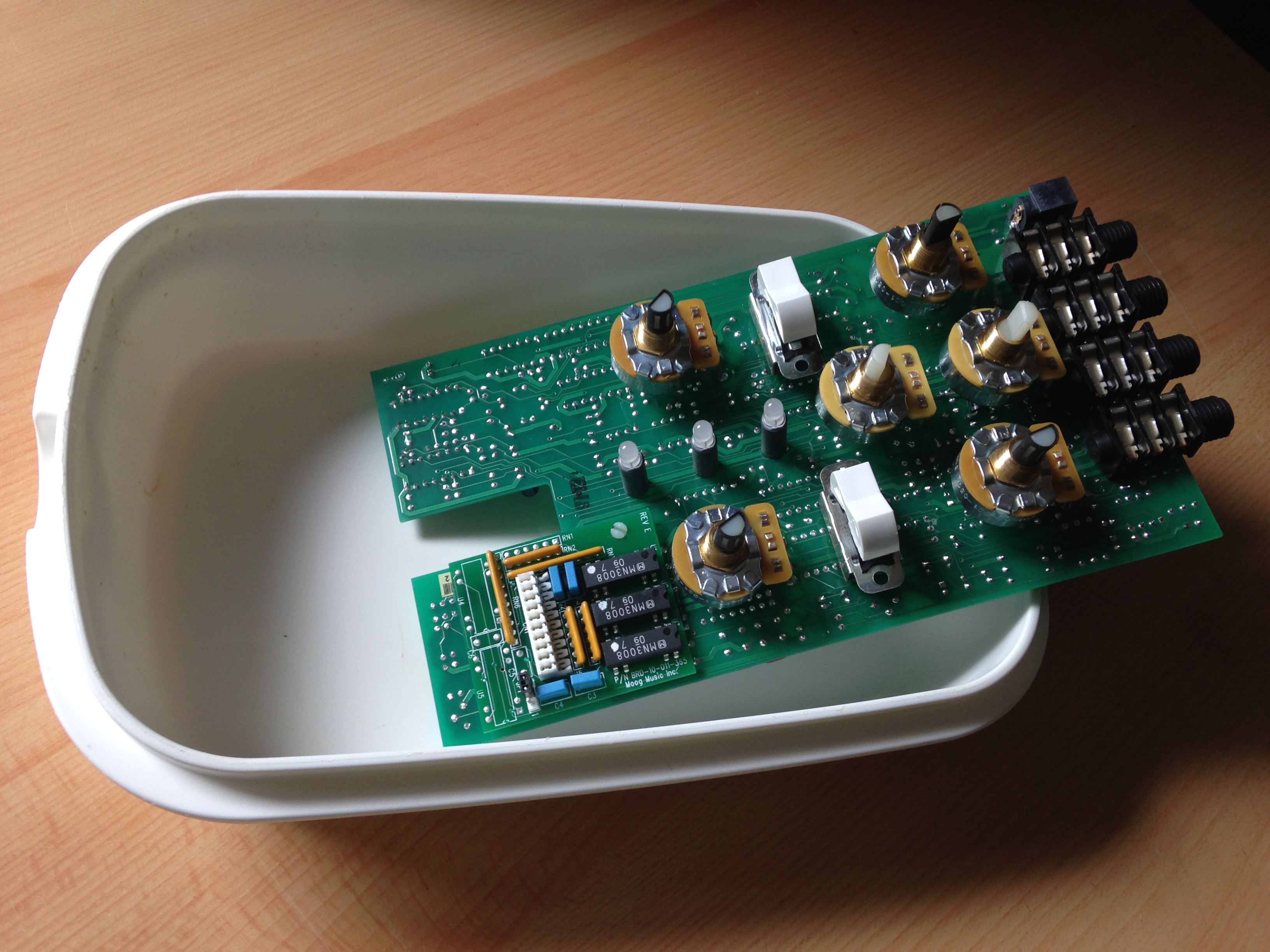

I’ve completely stripped down the MF-104Z from its case / knobs. I plugged it, and the delay worked fine for a longer time than usual, around 2 minutes, then the delay disappeared again… then reappeared after 30 seconds… then disappeared after a few seconds, then disappeared… etc
