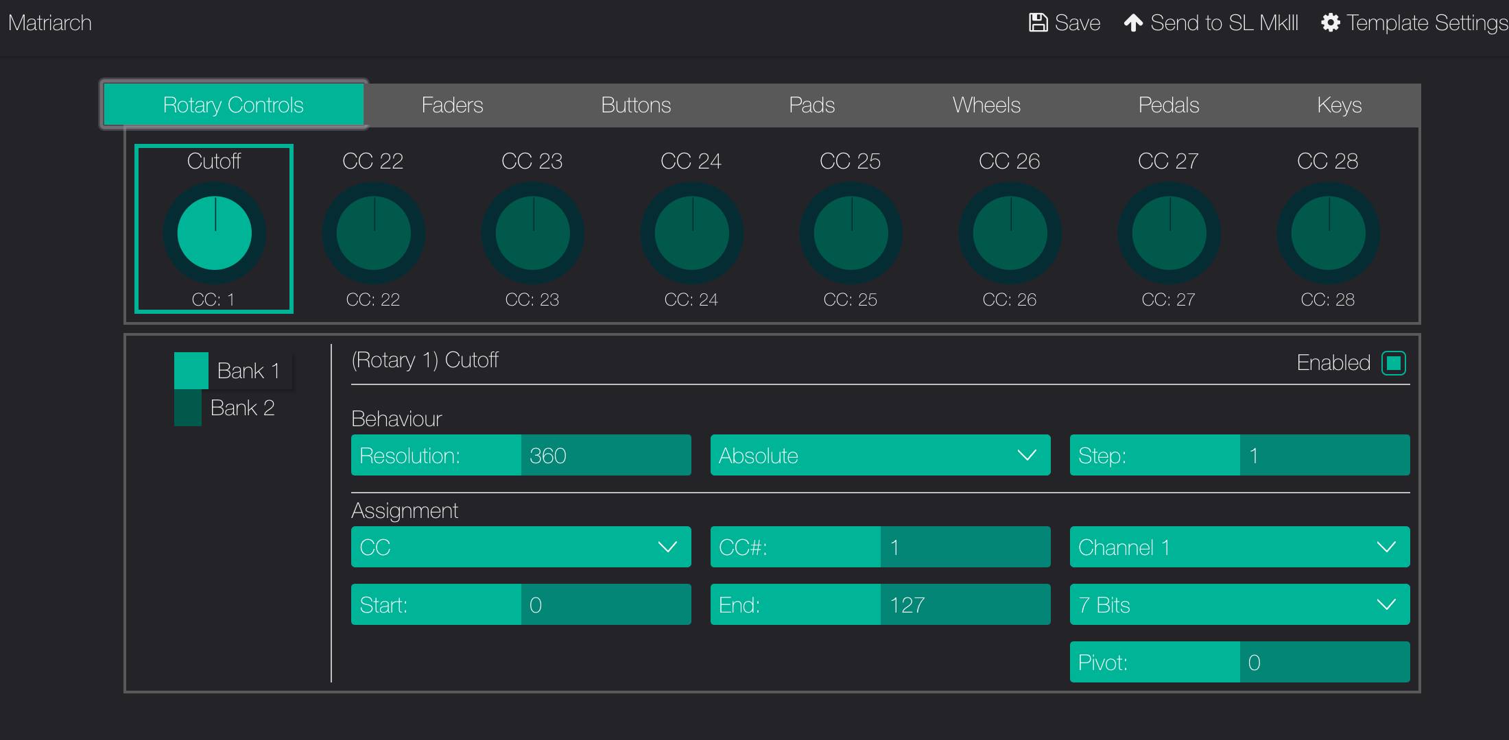

I’m trying to set up a very simple Matriarch template on my Novation SL MKiii and have tried to assign pot 1 to send cc1, and physically patching the Moog’s modwheel into cutoff 1. No lucko. It worked for a bit but sounded more like it was patched to VCF1… now it’s not doing a damn thing.
Any ideas on how to simply make the Novation controller control filter cutoff, or what I may be doing wrong here?
Would also be happy using the Novation’s modwheel for this, but that didn’t work either.
I don’t really know what MSB/LSB is, but somebody in a FB group suggested that could be an issue.

You’re not doing anything wrong. In most cases the Matriarch does not route the assigned CCs to the hardware output jacks.
Instead those CCs are controlling the destination(s) through internal hardware connections. For example where the midi mapping document shows CC 1 controlling the mod wheel it is in reality only controlling the LFO amount routed to pitch, filter cutoff or pw as determined by the knob settings in the LFO section. It does not affect the rear panel Mod Wheel out jack. Same with velocity; only the Matriacrh keys affect the velocity out jack, It’s not affected using midi.
I’m not sure if this was intentional or an oversight. But there is one exception - After Touch which does affect the output jack.
If you can set up your Novation to send AT using the mod wheel (or even just using the keys) hook up the rear panel AT jack to VCF 1 cutoff. Just tried it with my Kurz PC3x- works great.

yeah after digging all over the internet i found the same answer in a couple places. but didn’t think to assign the modwheel to AT. the AT on the keys do work. just not the most ideal way to control cutoff, relative to what i was trying to do. good for expressive playing, surely, but not for long form automation etc. thanks again! hopefully that’s something firmware can fix, though i do get that it kinda contradicts the nature of the instrument, in a way. still think that should be up to the user though :smiley:
