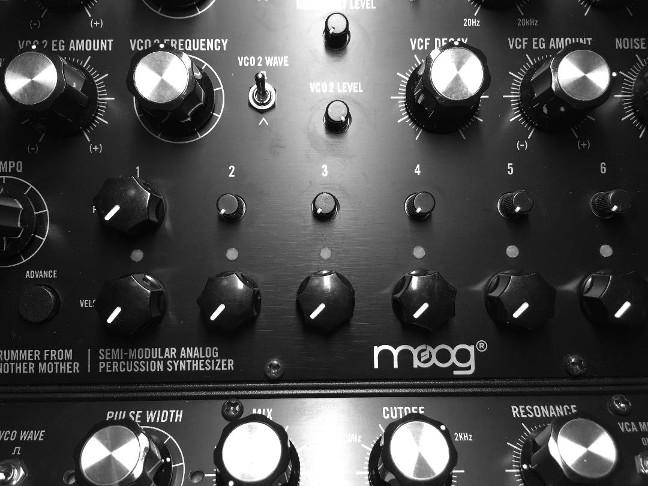

I ordered some high-quality knobs from:
https://www.mammothelectronics.com/collections/plastic-knobs
I used 16 of the “1250 Series Fluted Plastic” knobs for pitch/velocity.
And 3 of the “1900 Davies Style” knobs for the VCO’s.
Then, I adapted this brilliant hack:
https://youtu.be/9pwYgESNBFc
It works perfectly: the hole in the 1250 knob is 0.02" larger than the DFAM knob and the thick “milkshake” straw is 0.01" thickness = a perfect fit!
Make sure to cut the plastic straw insert to 0.2" x 0.7"
The thick plastic also acts as a protector to your DFAM knob when you tighten the screw on the new knobs!
Much more precision dialing in the pitches and velocities.
Here are some photos:

That last post. Holy knobs batman :mrgreen:
