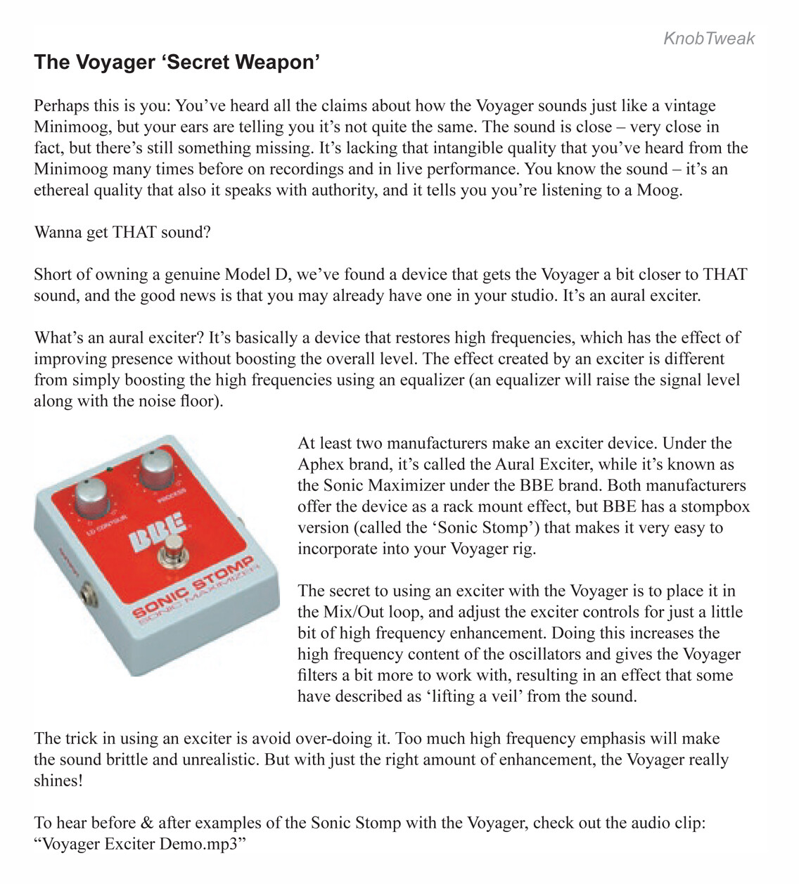

From KnobTweak, two articles related to the use of guitar effect pedals with the Voyager:
‘Secret Weapon’ (see below) – Using an exciter with the Voyager.
‘Kicking It Up A Notch’ – Overdrive techniques using pedals.
Both articles are ZIP files that include mp3 examples. To download, look in the Voyager section under Files:
KT > Files > Voyager
  • Greg
Awesome. I have a rack version of an Aural Exciter, will try it. Maybe post an A/B video if I can find the time.
