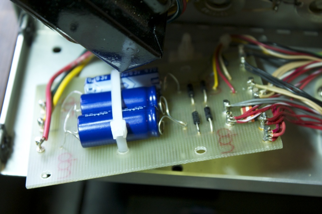

Everything I’m seeing has 2x 470uF caps. When you’re behind the Minimoog with the case open, the capacitor nearest you is + to the right, the further one is + to the left. That matches the markings underneath my board.

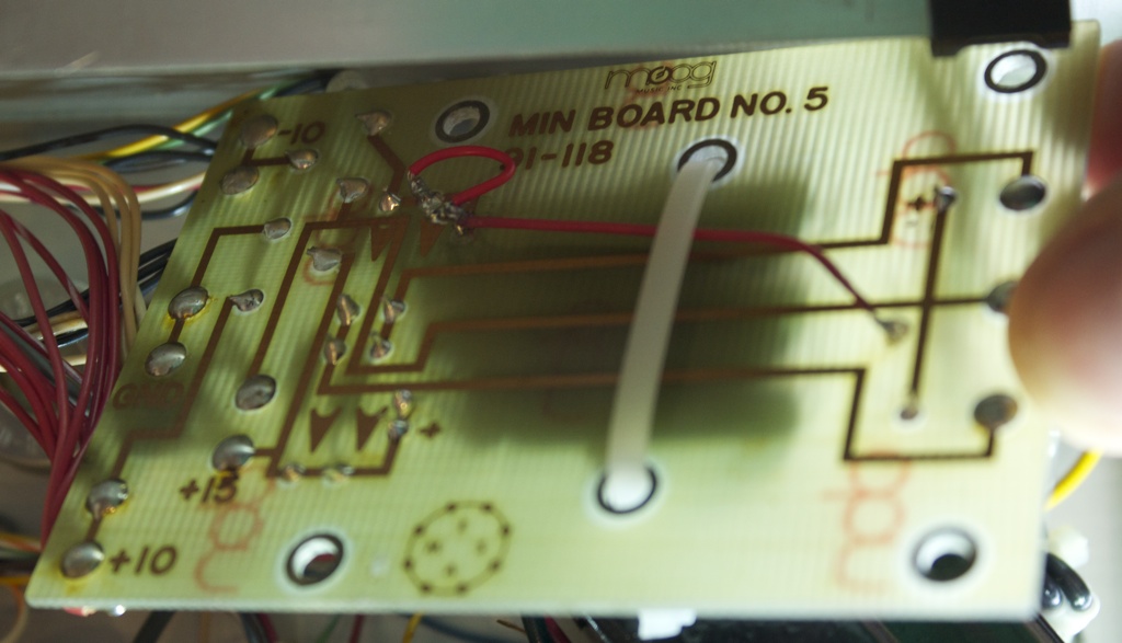

However, mine had 1x 470uF +left further from you, and 2x 1000uF closer to you, as well as a jumper wire underneath the board. Unfortunately, I wasn’t paying enough attention when I pulled those out, but my guess is they were both + to the right. I know 2x 1000uF in series makes 500uF. I believe I really just need confirmation that I should replace the 3 capacitors with 2 470uFs. I’d love to find a board scan for this specific board, and/or photos of one of these boards fully pulled out of a Minimoog, as I really don’t want to have to detach mine from the main wiring in order to look at this more closely.

Ah, should have noted that it wasn’t like that one. I’ve seen that schematic before, but hadn’t seen a photo of that one. My board seems closer to the boards with caps rotated 90 degrees from that, but only with two caps vs the three in mine.

I’m not at my place, I’ll have to take a photo of it later tonight. It’s definitely different than this example or the two caps facing the other direction. My guess is that it’s a hack, or Moog was out of enough 470uF caps so replaced one with 2 1000 uF caps.
Edit: actually, I had taken a photo previously, so here’s my board currently, but since it’s 3 470uF in the place where most of the boards with this orientation have 2uF . . .
That photo should be attached now.

Unfortunately, there are marking on the underside, but not for all three capacitors. The markings on the underside make it look like they intended to put 2 capacitors there, with the closer one + right, and the further one + left. Mine had the closer two both connected to the same point on the right.
