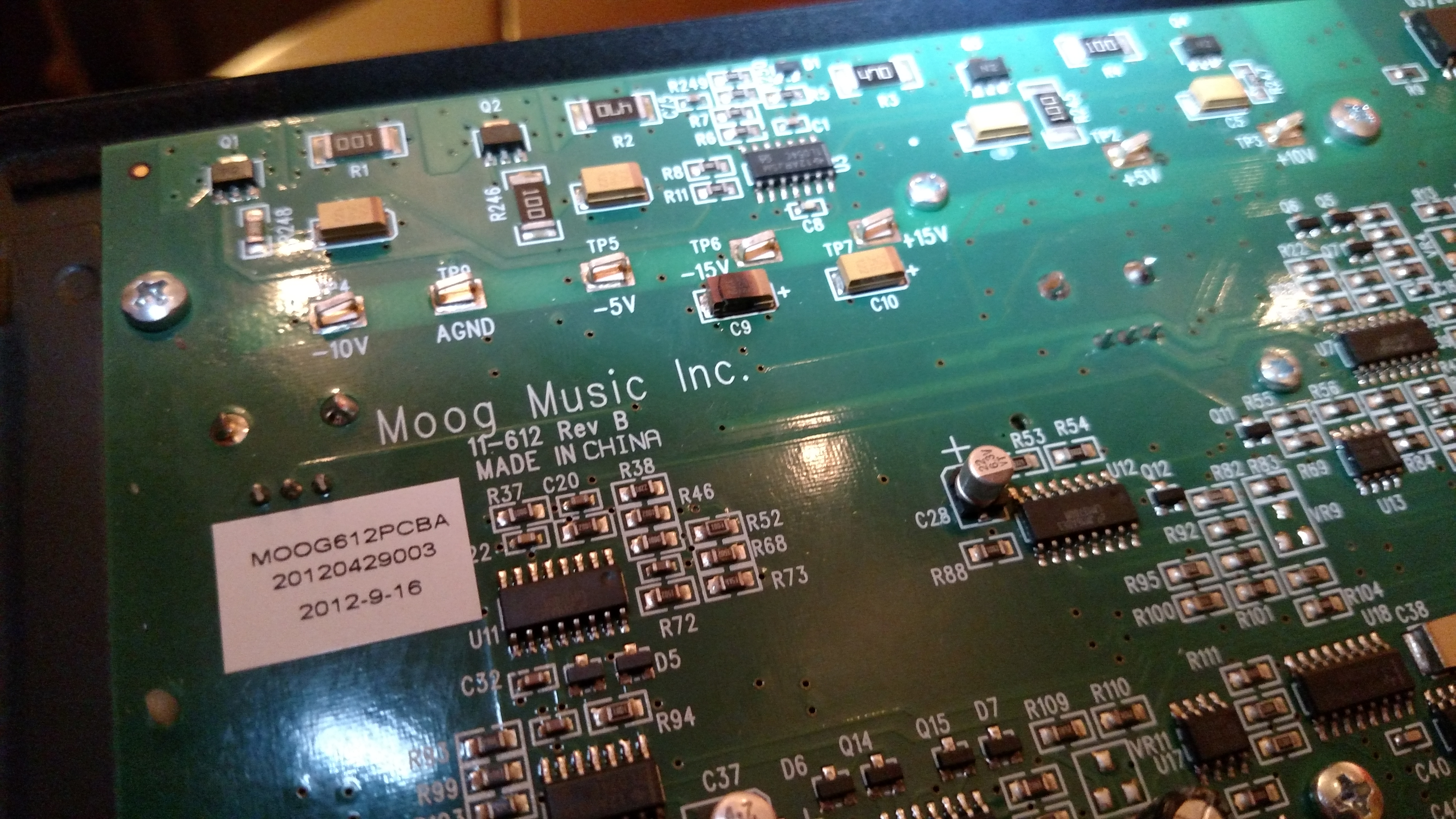

The warranty of my LP had already expired, so I decided to open it and see what had happened: http://dl.dropbox.com/u/10297487/moog.jpg
The component C10 (whatever it is) had burnt, but I didn’t notice other damage. I hope there isn’t any. Hopefully I can also get it fixed here in Finland. Sending it to the States (and back) would be too expensive. But anyway, I would have expected that my LP wouldn’t have broken so soon, just after about three years. :frowning:

tantalum capicitor go bang. when they fail, they go short circuit.
my guess, being right next to 2 test points -15V and +15V that c9 and c10 are bypass caps. when c10 failed, it would have pulled down the positive rail, but shouldn’t have damaged anything fingers crossed.
Try replace (or getting replaced) the capacitor, hopefully it will come good again.

My C9 is the burned out capacitor, right next to OPs burned out C10. I really really hope none of the other components are fried. Dont see any more damage though. Anyone have a clue how involved this replacement of the c9 component is?
Lol aisling, check out the origin stamp on that board!! MADE IN CHINA!!!
^ :open_mouth: :frowning: but the actual units are assembled in the US hopefully? Or do I need to buy a Roland in order to get an American made synth :slight_smile:
