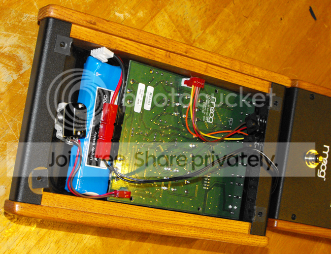

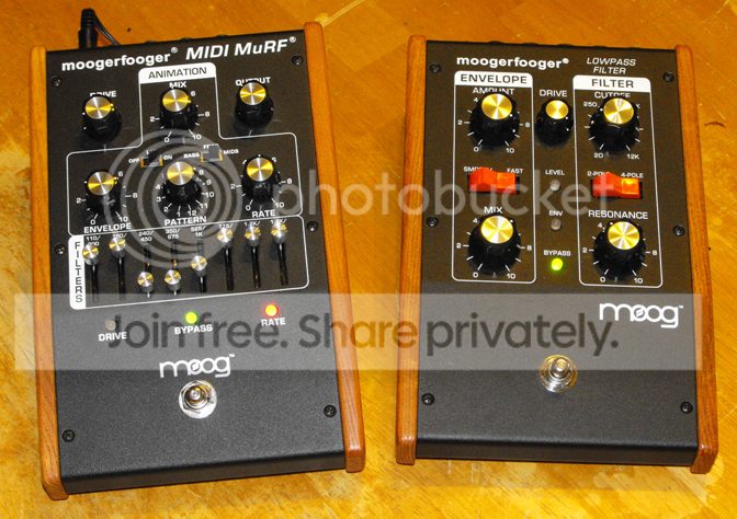

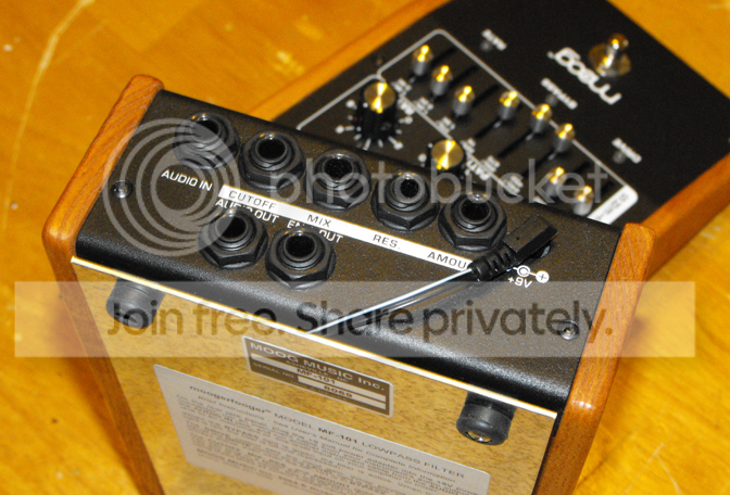

I am TOTALLY with you on battery powered pedal and stuff. I should have done this long ago. All that was required are a couple of 9v plugs from old adapters and a pair (of pair) of Sermos connectors. I picked the batteries from what I had that would fit in place (and that I had in stock). I would not recommend for people to power their foogers with lipos, just as I did. These batteries must be handled with very specific care. Use AA’s or AAA’s instead, rechargeable or not. I would have used them myself (and I probably will) but you need to make a special battery holder, that’s a chore, so I went for easy does it :wink:

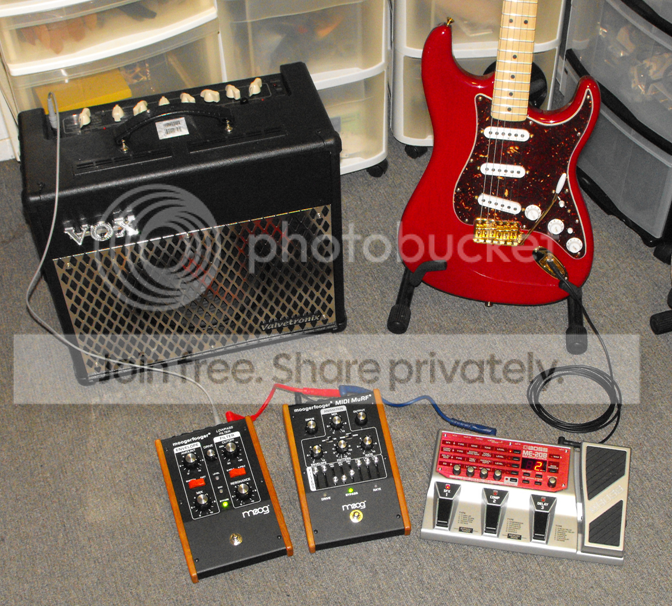

So here’s my battery operated pedal gear. The little ME-20B is an essential sound beautifier for my basses. I just go a new Strat with noiseless pickups and the ME-20B is absolutely great sounding with it. It was always good with guitars, but it seems to shine with this Strat, same with the Midi-Murf. I was all humbuckers before but this guitar sounds real good. (Not shown, a couple of regular exp’s for the foogers).
