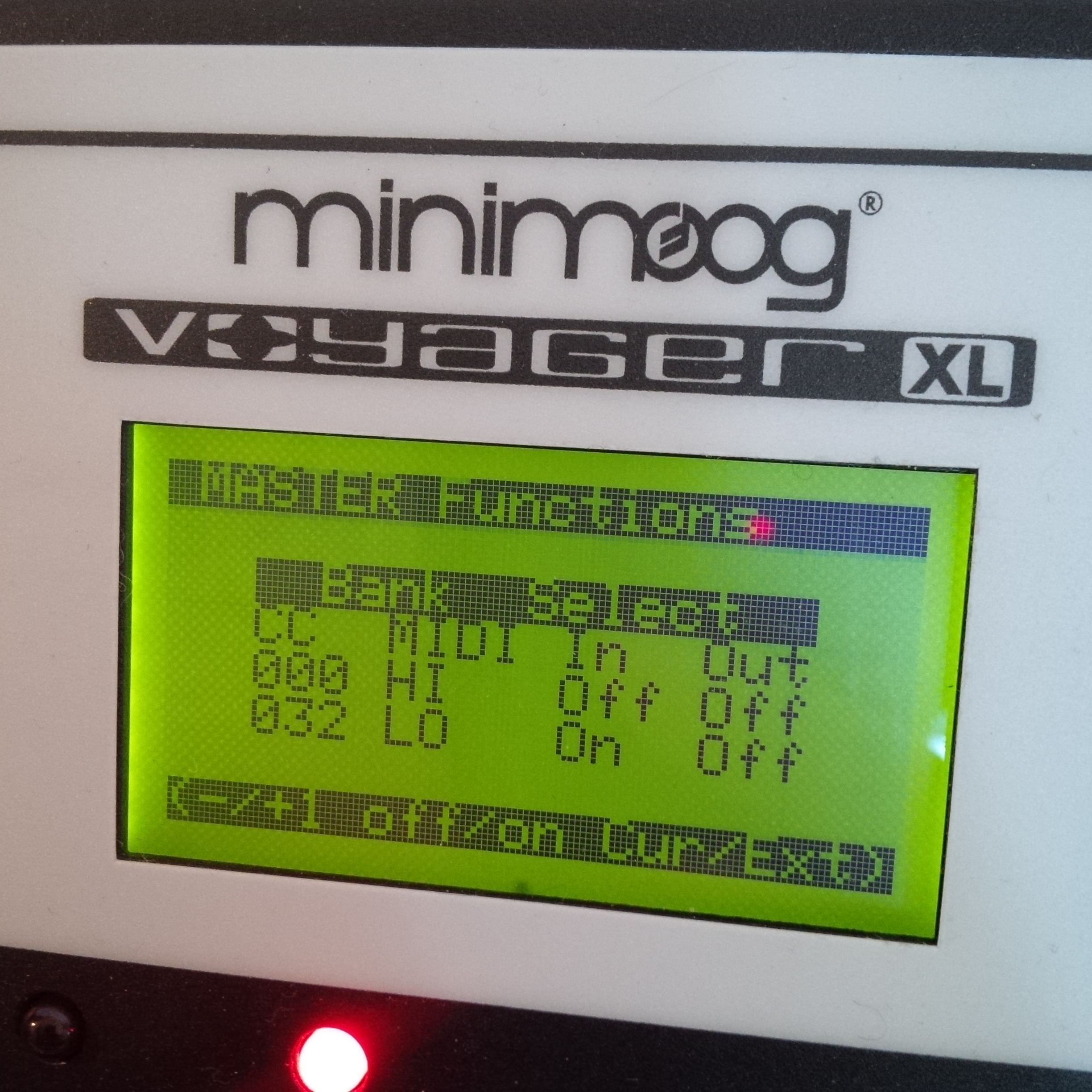

Is there a way to change banks via midi by only using the bank select MSB (cc0) or just bank select LSB (cc32)? Since bank select MSB is always “0”, it would be useful to change banks by sending only a LSB or LSB message (7 bits) from my sequencer, instead of the combination of both (14 bits).

Sorry, the bank controller is a defined controller and I don’t want to change that cause many problems can occur.
Thanks Rudi. Found out that by changing the “Midi Enables → Bank Select” to receive only CC 32 (see screen shot) I can change banks from my sequencer by only sending CC 32!
