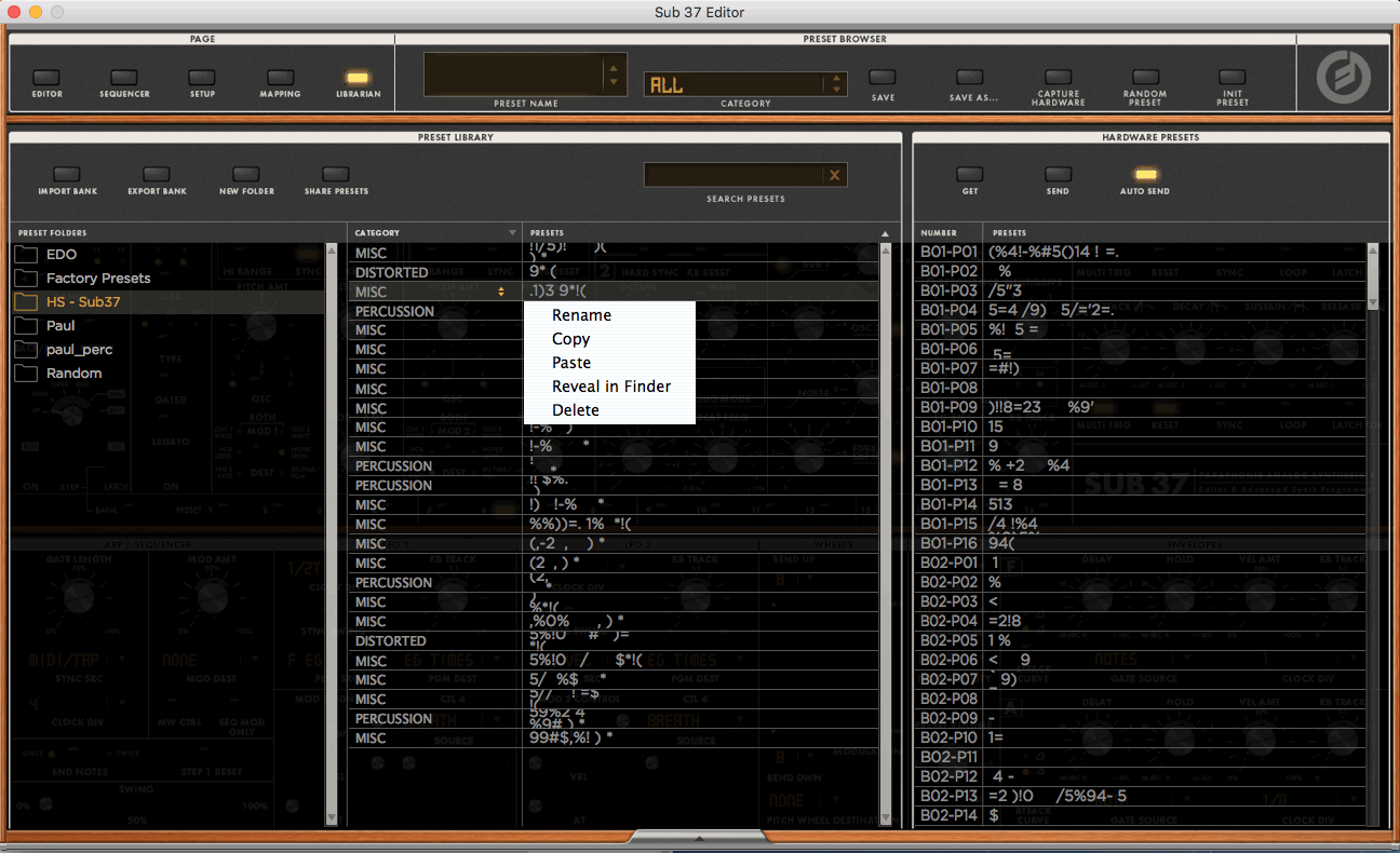

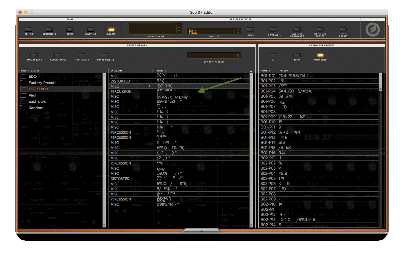

standalone mode is bit tricky as I have that weird character thing going on with preset names - but when I’m deleting presets with this, it’s actually deleting a different preset than the one I select eg:
Note the percussion preset being pointed to by the green arrow:

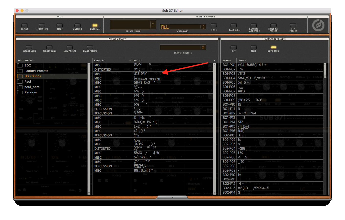

I select a different preset and delete it:
The preset I deleted it still there (red arrow) - but the percussion preset (green arrowed in above screen-shot) is now deleted:

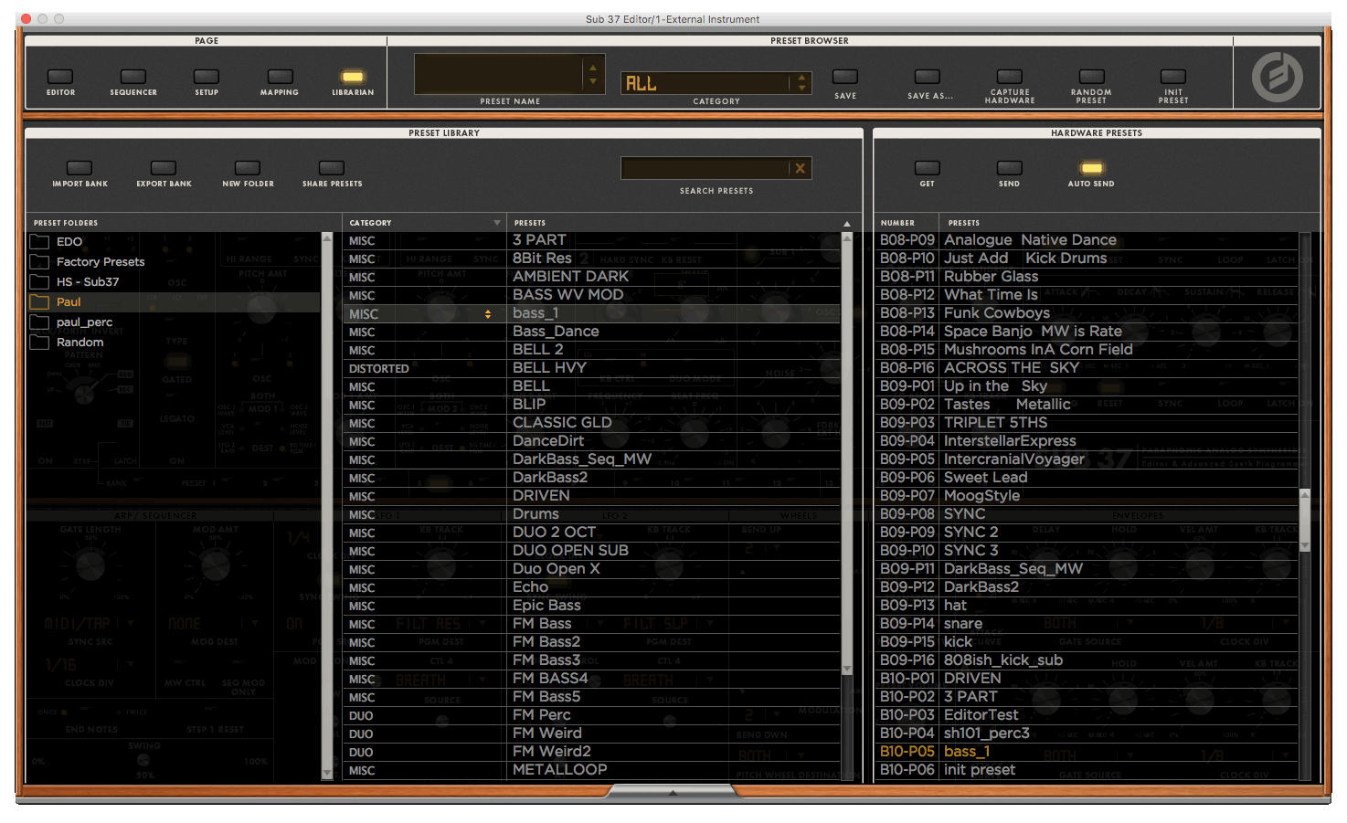

I take back what I said about using 0.9.29 OS X as a vst - I just tried to delete a preset and it deleted the wrong one (where the vst does show the correct preset names).
Here I select bass_1 and then delete it:

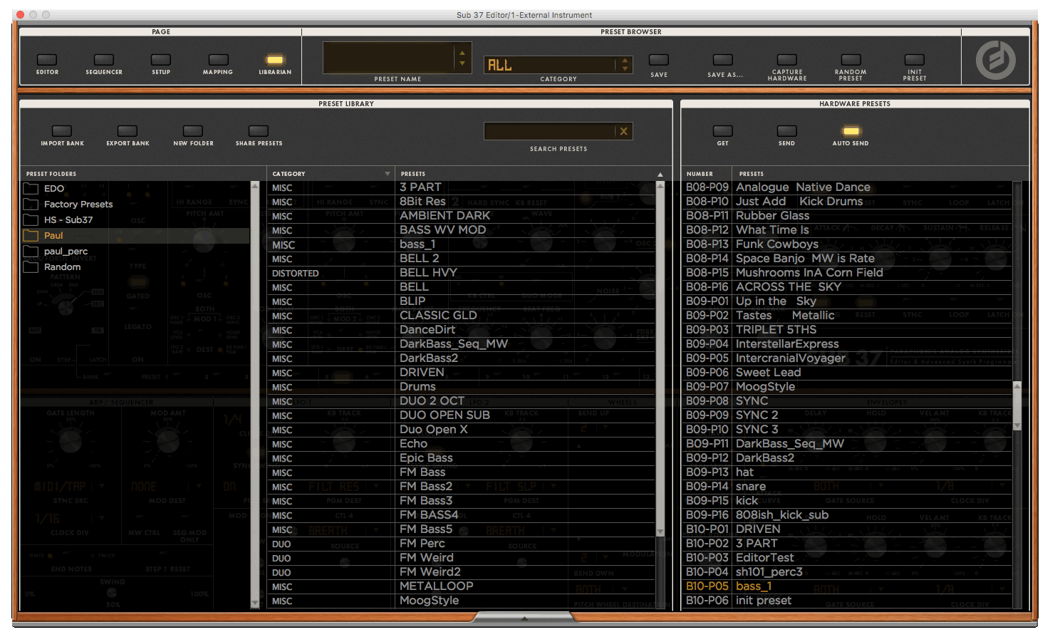

note that bass_1 is still there - it has actually deleted Bass_Dance:
