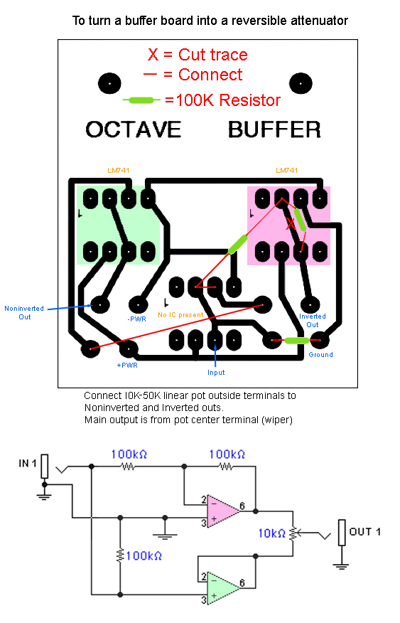

Kevin Lightner had a schematic using those Minimoog buffer boards on an Ebay auction. A little different design, but tested. Might want to try that one. Or even purchase one?
Ebay auction:
Synthfool auction for reversable attenuator
Hi Terry, and thanks for the research sir!
Well waddaya know…?! That works. Kevin Lightner is a star - !
All I need to do now is reign in it’s severity… for my purposes I don’t much variation across the range… maybe a tone and a half up and down max…?
Cheers again.
Tom

@ fyvewytches, thank you so much for this link. I was actually trying to find schematics for CP-251 for a long time and this is the closest I’ve come so far. @noddyspuncture, it’s amazing to see that you’ve got a work around from CZ, it’ll be really great if you can point me in the right direction as well since I’m in a similar situation as you. Would it be possible for you to please post some pictures and information about the circuit you built and what tuning parameters you used?
Hi, yeah sure.
I built this circuit: http://www.synthfool.com/ebay/revattnnabag2.jpg
But I needed a ‘finer’ control, not as extreme end-to-end, so what I did was change the pot’s value to a lower one - say 1K (instead of 10K) and I also placed a couple of 5K trimmers either end of the track… so for my purpose the pot only varies the tuning by around +/- 5 semitones.
I used trimmers so that I could centre the pot and then trim in the ‘dead’ zone - ie: zero output.
And it works really well…;c)
Tom
