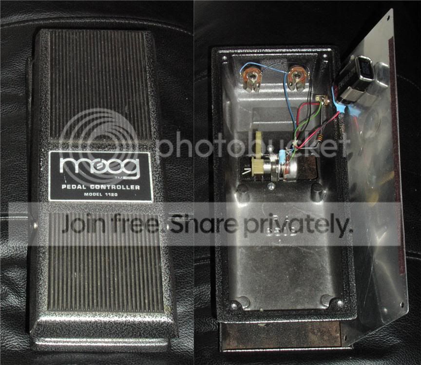

Those I use are the EP-2, M-audio EX-P, and the 25k Moog model 1120 controller, but that’s another story, they build things differently back then.
