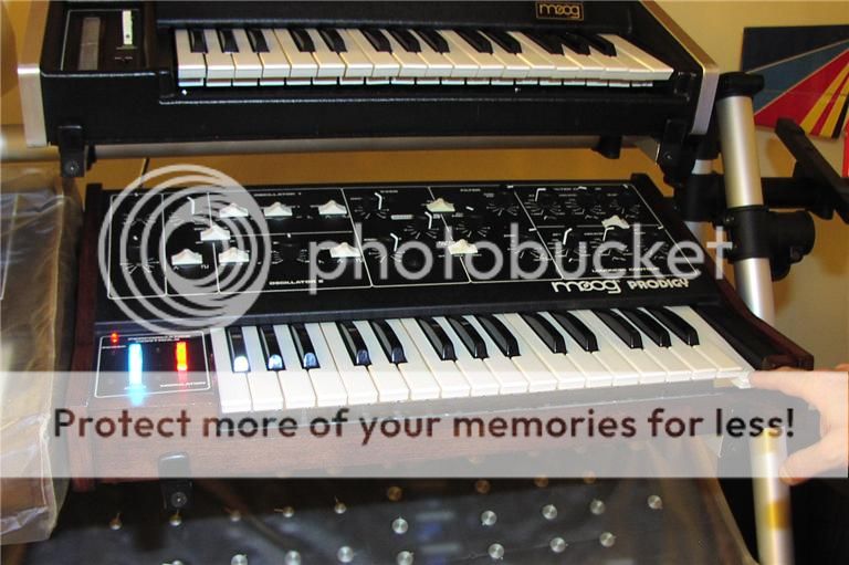

I don’t mind paying fair market value for top notch equipment. Like this modded Prodigy, fully refurbished, with plexiglass illuminated mod wheels, blue led for pitch, red flashing led (at mod rate, when a key is pressed).
Asking price was 1200. I hesitated less than my attack time on VCA fast envelopes. And it gets played much much more than the lilPhatty right next to it.
