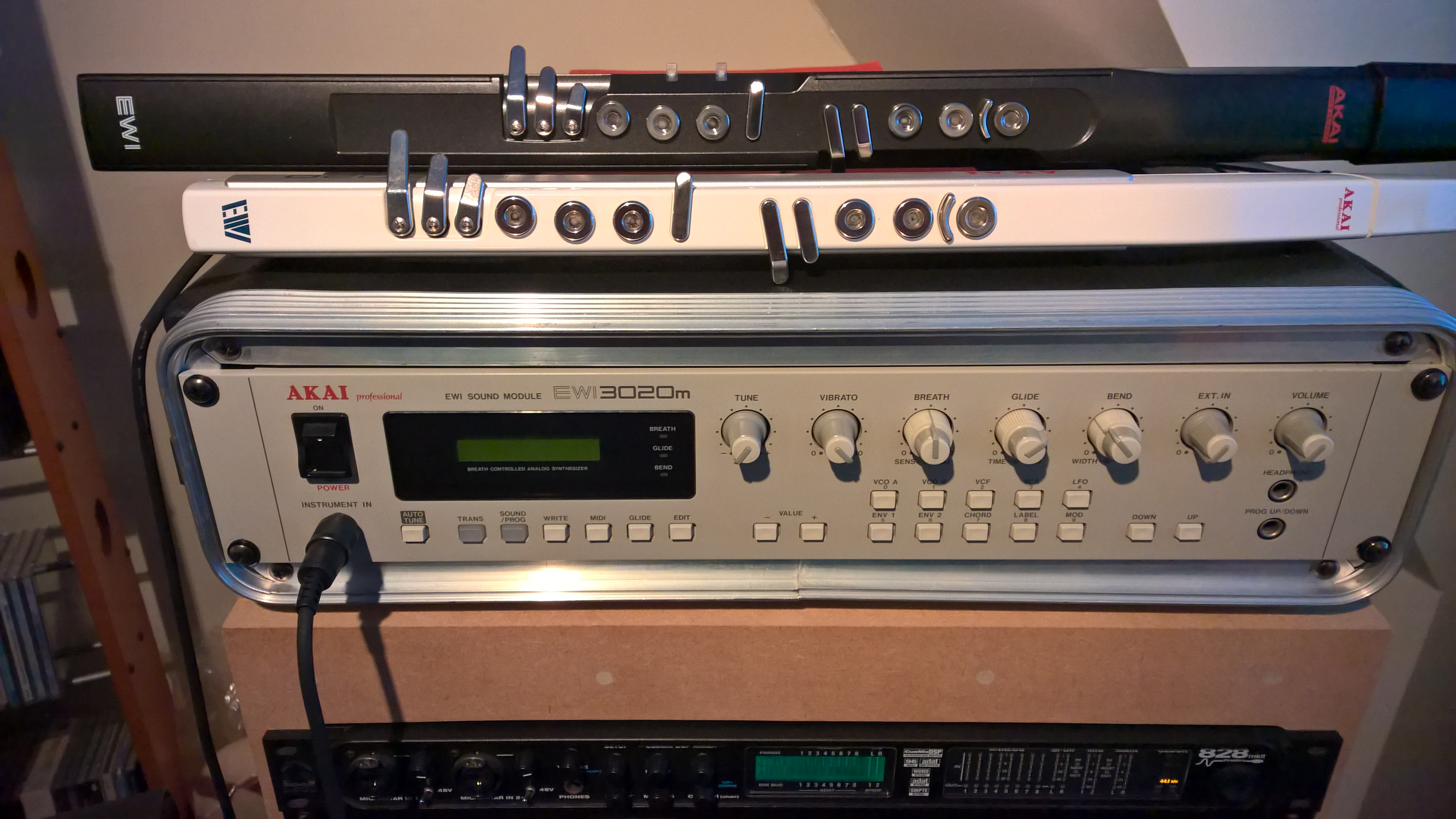

pic attached of grandad and grandson :slight_smile:
Very nice family indeed :wink:
