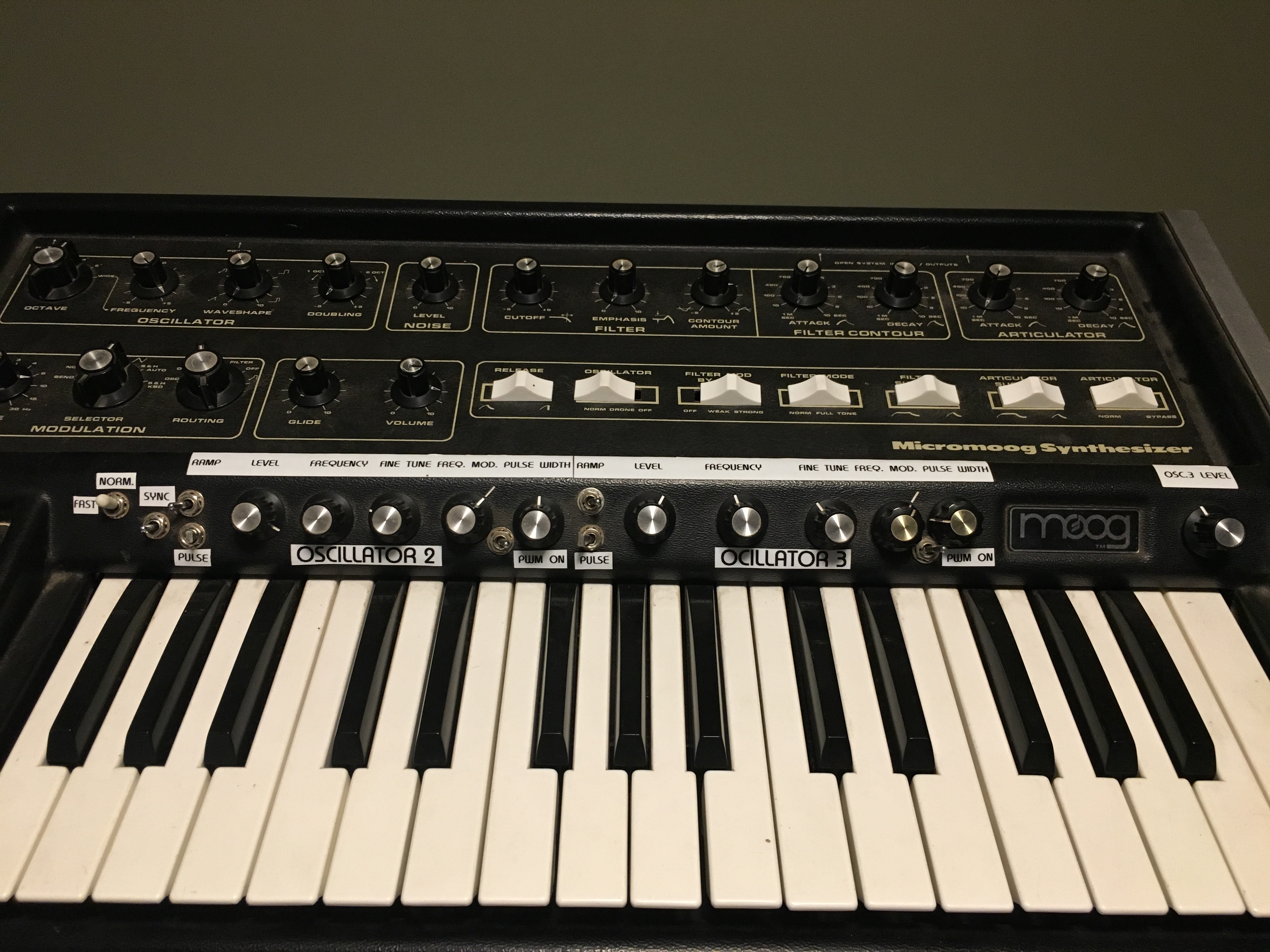

A few years ago I purchased a micromoog on craigslist that had been modded with two extra oscillators, a normal/slow/fast speed switch for the lfo, and hard sync for the extra oscillators. The new oscillators sound much fatter than the original. I have no idea who did the original mod but the synth is now a total beast.
Cool! I would love to hear this. Is there any chance that you will be uploading some audio or video of this modded Micro?
